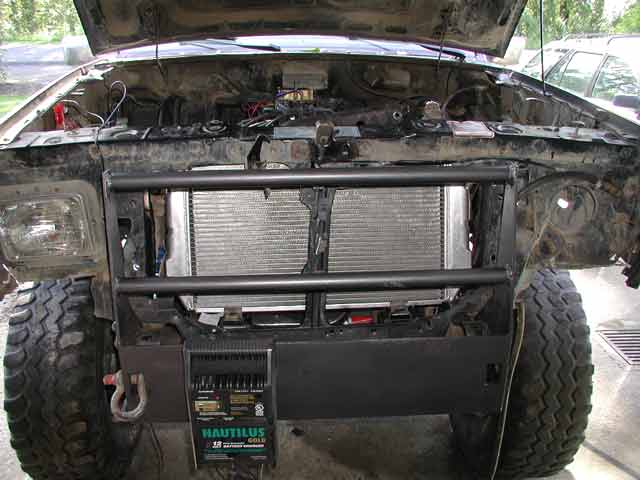

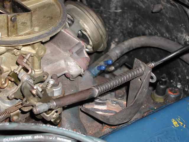

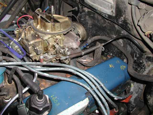

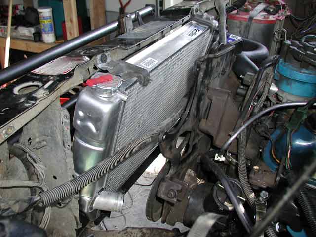

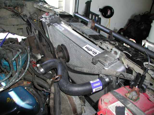

![]() ![]() ![]() ![]() ![]() Day 7 - Thursday Got radiator mounted in place. I decided not to cut the top of the radiator support...instead, I leaned the radiator in toward the engine. I'll be changing this soon, and standing the radiator up straight. I didn't quite have enough room to get the belt on my A/C pump for onboard air. Found a top radiator hose easy enough, but struck out on a bottom hose. Modified the throttle cable bracket and hooked up throttle cable. |
