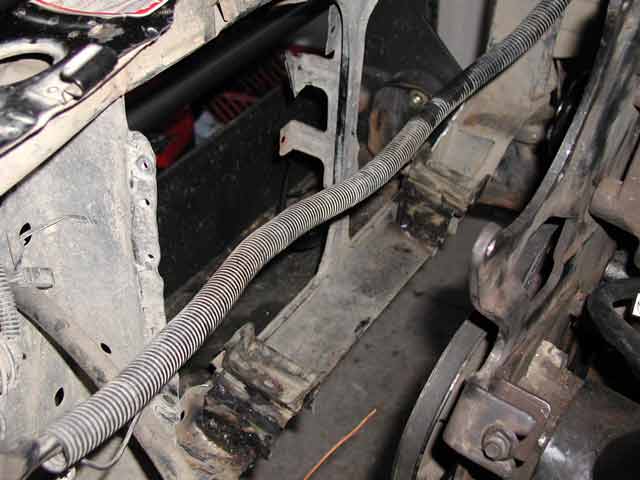

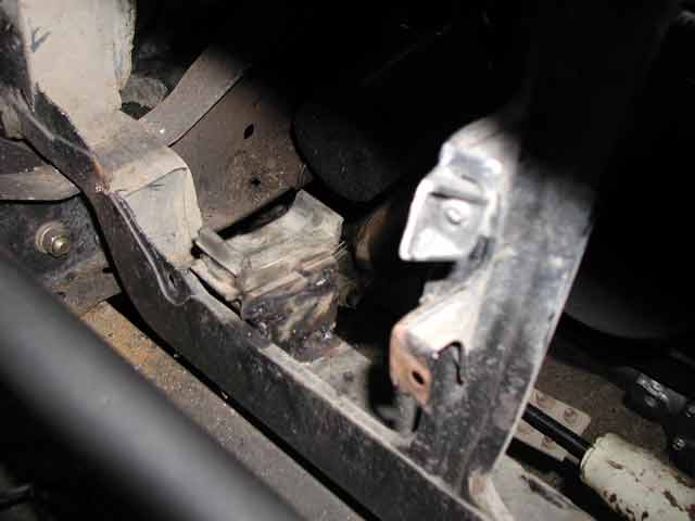

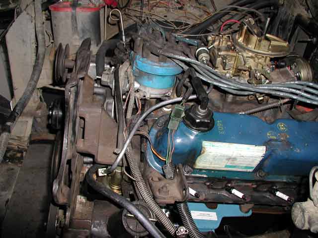

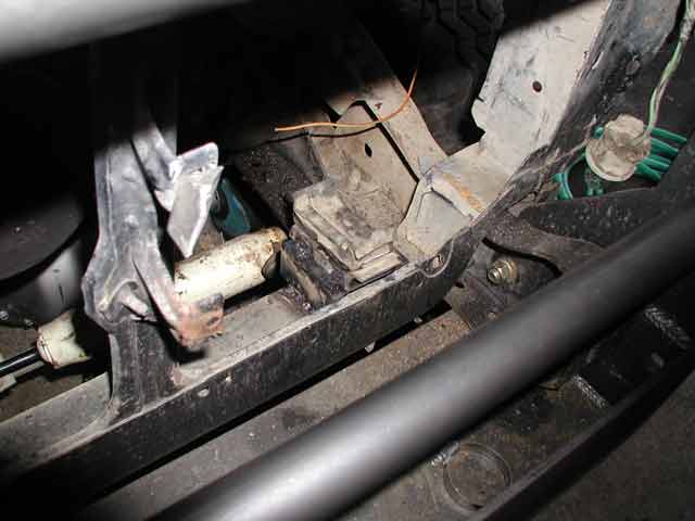

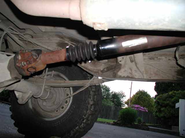

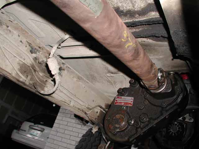

![]() ![]() ![]() ![]() ![]() ![]() Day 5 -- Tuesday Got a driveline from a ford exploder. Had it cut down.. cost me about $100 I think. Made a fuel line....I used an inverted mechanical fuel pump from a 73 ford van. This worked out really well. Re-used old radiator mounts and relocated them up inside the rad support. That's it for day 5 |
