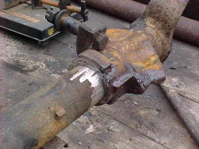

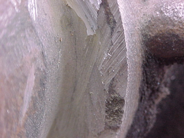

look close yopu can see the crack
<br />in the weld this will need to go all
<br />the way around before it will come
<br />off.
<br />

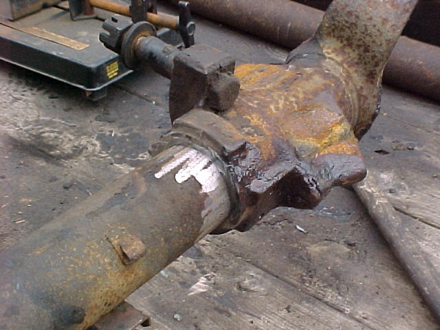

<br />  i used a big log splitter to knock the cast
<br />wedge off .worked like a charm

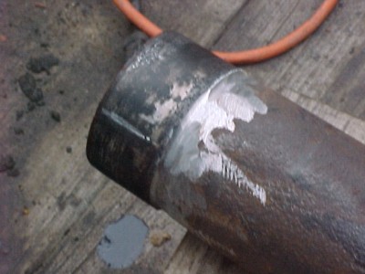

off.

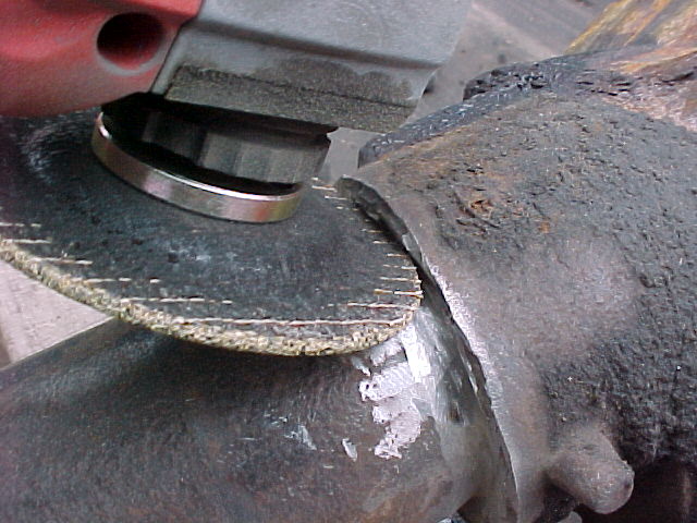

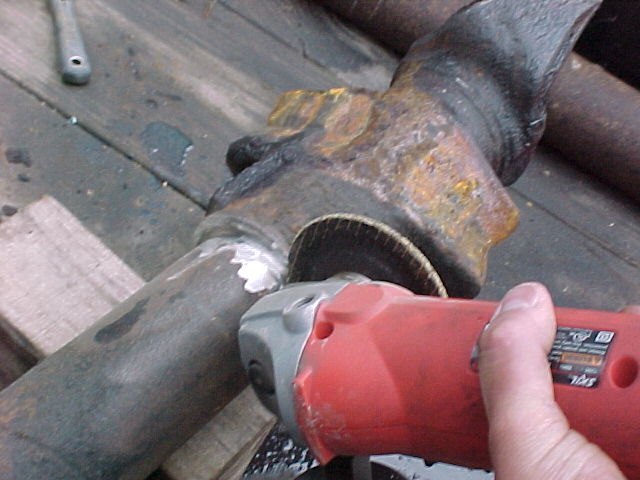

turn your grinder so that you can
<br />grind a little into the cast wedge so
<br />that you crack the weld

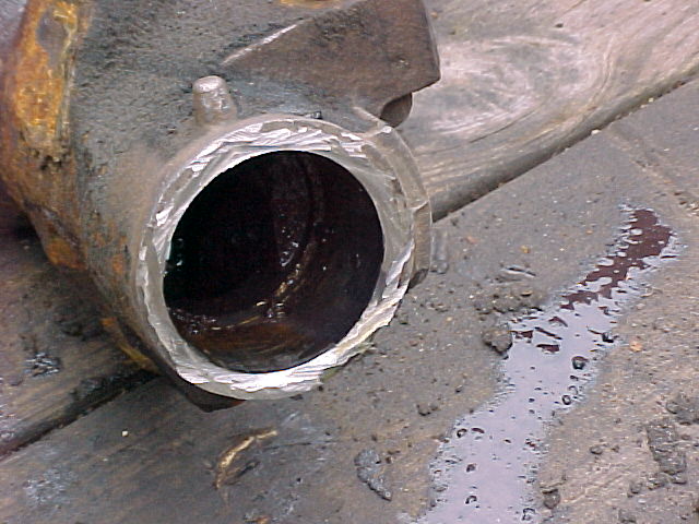

Grind untill you get
<br />this look
this look

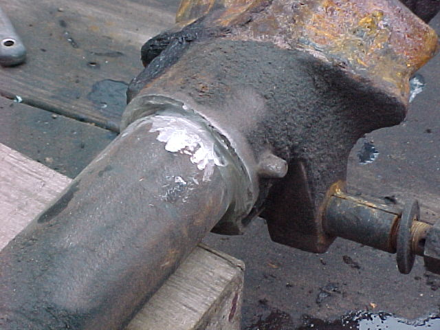

then grind the weld off from
<br />around the outer edge

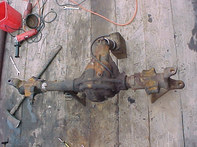

now this is the important part remember were i said to
<br />measure things ,now get those mesurements out and set
<br />it back up like it was before you choped ot down ,then
<br />weld it ( if you trust your welds go for it)  i had a friend
<br />weld mine back up he h
then i used the same splitter to tap
<br />tap tap it back on .
