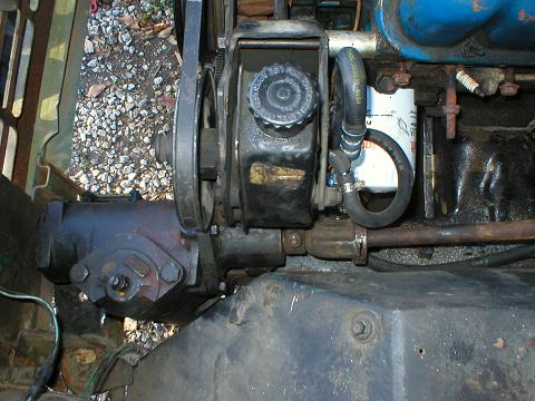

how's this for a clean install?
That's pretty much how I did my BII at first. I think you'll find that you are lacking in the cooling department. I added a cooler, but at the very least, you should add in a length of steel tube on the return. It will be fine like that for street duty though.DBrown wrote:how's this for a clean install?
I also have my HP line bent at an extreme angle like yours. I was concerned about it, but it's been fine. With the addition of hydroboost, that's all about to change.
I planned to do some type of cooler line but I am just trying to get it running and move it around the yard at this point. still have to plate the frame and do the connection at the steering joint but I am ready to fire once I get the manifolds and radiator in.
