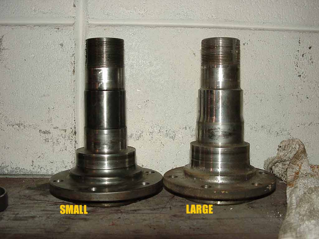

Chevy Early Small Bearing Spindles (same bearing as ford about $11ea at the yard when you can find them.

The hardest thing to find is the spindles. Luckily dead chevys are plentiful, so the are pretty common. You can get them new for about $100ea I think.

The small spindles came on *some* 6 lug dana 44's. I believe 72-76 is the year, but parts get swapped out over the years.
I think this is the part number 376853
