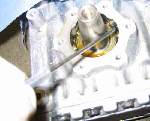

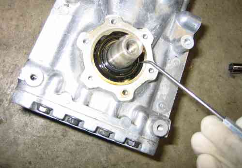

carefully pry out the seal, you will be reusing it

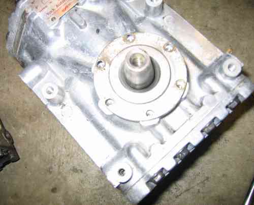

remove the woodruff key, cover plate bolts and plate

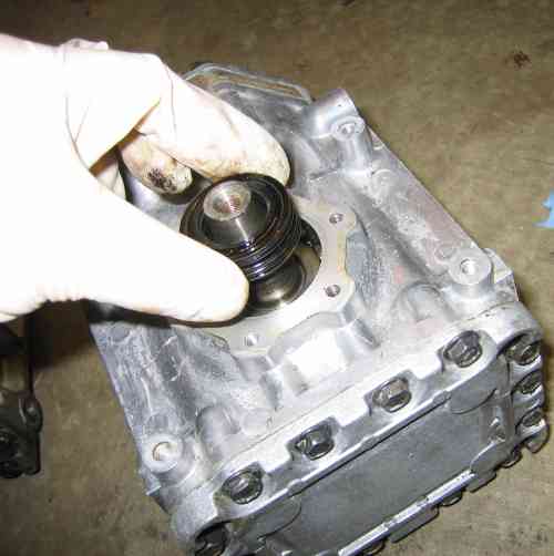

pull the rest of the assembly by removing the 4 bolts

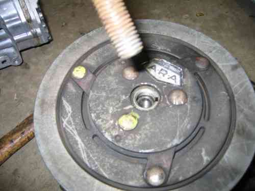

thread in a bolt to press of the pulley, IIRC it's a 5/8-11

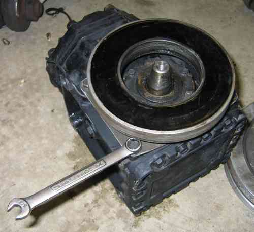

remove the clutch pulley, this can be tricky since it wants to turn so I tap the 1/2 wrench with a hammer to get it free

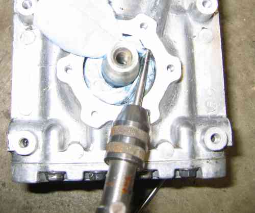

install the set screw as a plug and reassemble in reverse order, make sure to line up the woodruff key, when installed turn the clutch on to hold the pulley and do a final torque to the pulley bolt
cover the bearing to keep as much out as possible and tap it 10-30

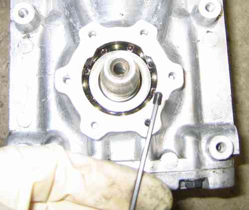

you can see the small hole
