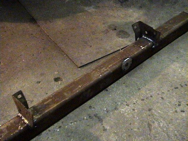

The new rear bumper/tire carrier...
The hinge...
The main bumper beam is 4"x4", the arm is 2"x2" and the rest is 1"x1". It is mounted using the stock brackets, we just cut them shorter then notched them so the tube set in them about an inch (more welding surface that way). The hinge is made out of a greasable shackle bolt that my fab guy has a bunch of. Just have to finish the latch for it, weld the 2" reciver on, add a support beam on the other side, lower the tire about an inch, gusset all the angles and then give it a good coating of rubber undercoating. I'm also looking at clevices or tow hooks to bolt/weld too it. This thing is strong, along with the tire mounted, my fab guy and I both got on it, about 400 pounds total I would guess. ;thumby;
The hinge...
