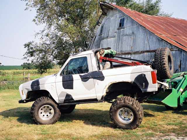

Pig Pen Jr's Off-Road Toy
1987 Bronco II XLT 4x4
2.9L V6
Mazda 5-Speed Man
D35 cut/turned front axle (4" lift) 4.56 gears and EZ-Locker
7.5" rear axle (3" blocks/etra leafs) 4.56 gears and welded
Chopped and caged
Custom ext. rad arms
Stock 2wd Ranger coil buckets w/Skyjacker 6" coils
F-250 front shock mounts w/Rancho RS5000 shocks
Extended stainless steel brake lines
Warn manual hubs
Custom front bumper w/winch mount - Custom rear bumper w/ clevises
Runs on 33x14.5 Boggers on 15x10 rims

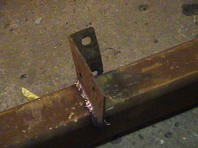

The new rear bumper/tire carrier...
The hinge...
The main bumper beam is 4"x4", the arm is 2"x2" and the rest is 1"x1". It is mounted using the stock brackets, we just cut them shorter then notched them so the tube set in them about an inch (more welding surface that way). The hinge is made out of a greasable shackle bolt that my fab guy has a bunch of. Just have to finish the latch for it, weld the 2" reciver on, add a support beam on the other side, lower the tire about an inch, gusset all the angles and then give it a good coating of rubber undercoating. I'm also looking at clevices or tow hooks to bolt/weld too it. This thing is strong, along with the tire mounted, my fab guy and I both got on it, about 400 pounds total I would guess. ;thumby;

Pig Pen Jr. bumper looks great how did you mount it to the frame? do you have pic's of the mount's? im wanting to build something similar.

We just reused the stock brakets. Cut about 2" off them, then notched them so the tube slid inside and just welded her up.
sweet thank's i was hoping to do that on the front but found out that the front does'nt have any bracket's so assumed the rear was designed the same. thank's again
