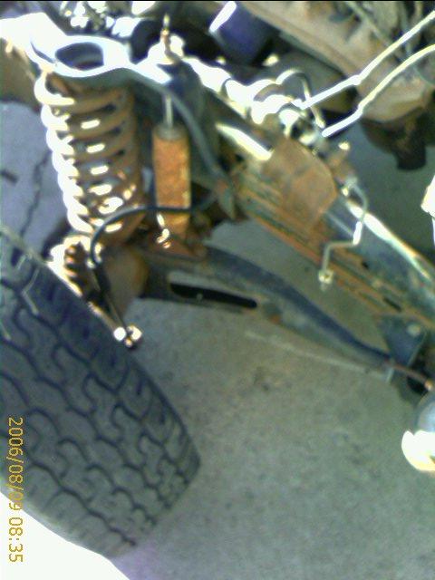

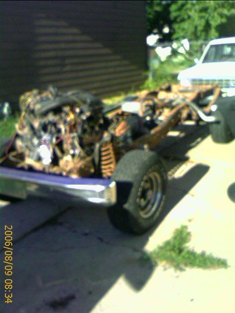

Ok I got the whole rolling chassis with harness computer everything. I want to take the suspension off of the 86 F150 frame. I have looked everywhere on this site and nobody has done this conversion that I can see maybe it because there is alot of fab work but I like the idea of having full size axles and suspension on the BII. If anyone has done this conversion and has any tips for me I would greatly appreciate it. I have added some pics so you guys can see what I'm tackling. this should be a fun project thats for sure I'm not sure the twin traction beam is the way to go but it's cheap for now. I'm not sure what kind of axles they are or what the transmission and transfer may be I'm a chevy guy, but the bronco was a free be "breefee". so I want to make it the craziest bronco II in utah no offense Phillipi becasue yours is prety wicked. Guys I want to do everything myself without a professional fabricator so lets put our heads together and make it a new conversion. oh yeah and does anyone know if the computer for the f150 would hook right into the bronco II ports, so that I have to do less wiring.

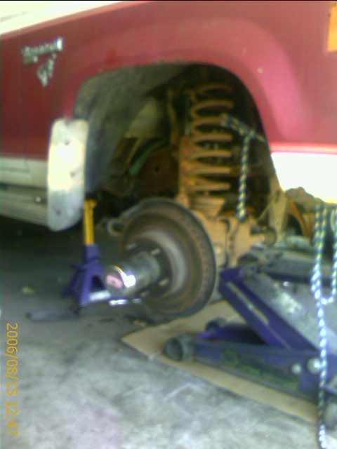

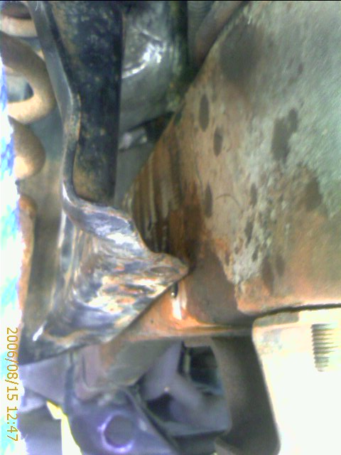

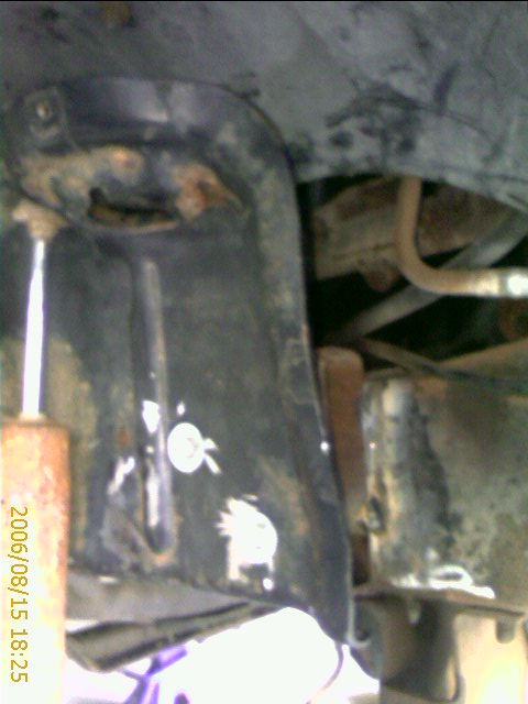

well one side is in and it took alot of fabrication on my part I had to build up the frame with 2X6 channel iron for the gap in between the coil buckets. They are just tack welded for now in about six spots so that once I drive it to see how straight it drives I can go back and either move them or grind the welds and adjust the caster. I used the buckets off the f150 too the BII won't work don't try it you'll be wasting your time, but the cool thing is the TTB bolts right up to your existing drop brackets, the only problem is it leaves a 2 inch gap this is where the channel iron comes in. I plan to start the drivers side tommorow I've already got it prepped. The problem i may run into is the traction bar off of the axle that may be a little fun to make it work, probably have to build up the frame. :wtf:
And that is the reason the springs aren't tight they will not mount to the existing frame trust me on this one I tried. :mad2:
balance will be out ragous when wheeling over rocks, the tires are on the outside of the fender reminds me of a low rider with Huge ass tires LOL.

pre Fabrication "lots of fun" Get out the grinder and hammer, chissel and punch

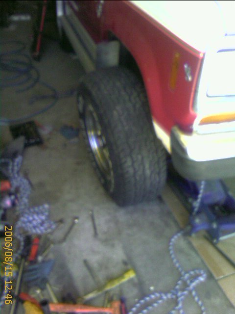

Not the best pic but it's sitting on the ground on 31x10.50x15 the tires start at the edge of the fender.

you are correct you can use the stock springs off the f150 but you can't use the BII coil buckets or the coils. the f150 coils are oblong shaped at the top and the BII are round at the top. The axle housing is too long for it to work without modifying it. I think it will be a pretty cool wheeler when I'm done adding the 8 inch lift the advantage i have is once it's done everything off of an f150 will fit my suspension. rear axles will be a pain in my butt I'm sure gonna have to move the leaf spring seats over and change the spring to the f150 leafs. and everything from the suspension up is for an 86 one way or another. whether it will ever be legal on the utah highways is another thing.

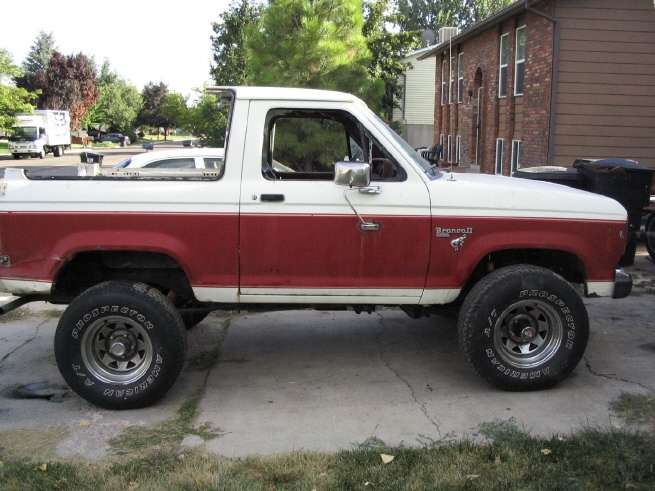

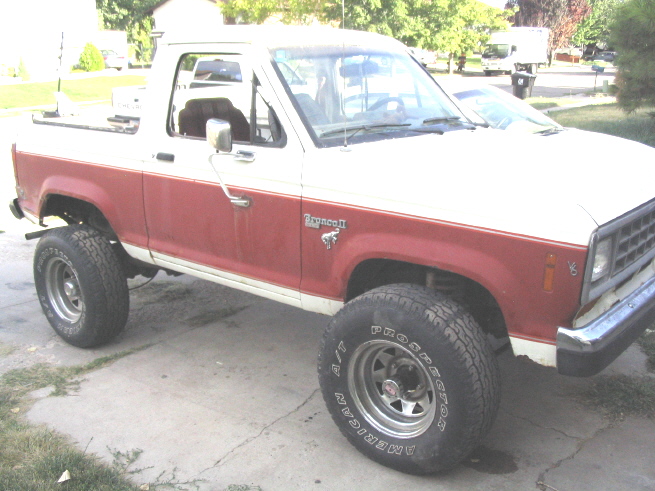

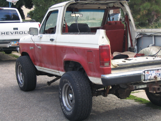

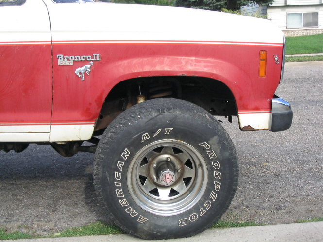

well it was alot of work and it works but I need to make some final adjustments on the ride height in the front one side is taller than the other and my camber is way off other than that I'm pretty much done for now I will probably trim the fenders later to fit the 31X10.50.15 already shown in the pics. these are the most recent of the pics and it's still not where i want it but it does drive down the road and turns a complete circle within an area of 35 feet. the stock ford blocks are gonna be gone the next chance i get to work on it. vaction is over now so back to the real work. any questions feel free to ask.
tires stick out way past legal limit here in utah so it will be a trailered toy when I find one. turns like a dream almost too good probably not a freeway driver. Yes you're not seeing things that is my chevy go ahead and make your jokes i wouldn't expect

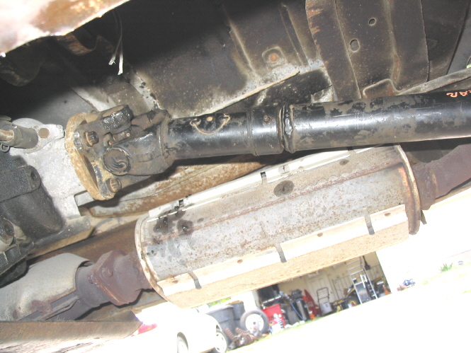

ok this is actually where you have to mix the u joint sorry but it was fun tring to make it work if you use another trans you shouldn't have to worry about it but if you use the stock auto EOD i think then you will have to buy two ujoints to make it work
junk yard driveline $75 custom made for a 87 BII with a 4 inch lift I got lucky with this one oh and spicer doesn't make a u joint so if you need to create one for the 8.8 let me know I have the two you have to mix to make it work fun stuff
this is the front this is 1 inch higher than the left side but I plan to fix that I thought i had it taken care of i guess my garage wasn't as level as I thought
the rear is too high compared to the front but lots of clearance this way those are 31's

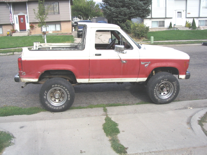

pic attempt #2 ok now i know it has to be under 1K to attatch thats good to know
sitting in the driveway after test drive I plan to take the blocks out of the rear so it sits more level looks funny
better pic I think
better pic I think
