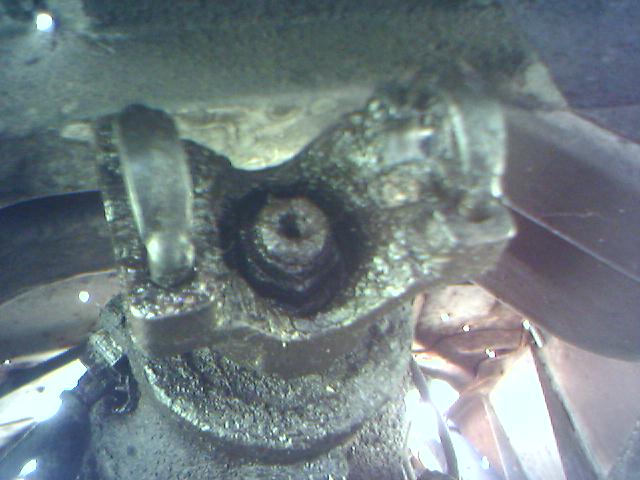

well I crawled under one of the donor vehicles (1973 Ford RV chassis I bought for $10.50 on ebay :tongue2: ) today and started to pull the drive line, rear end (Dana 60 with 3.73 gears), when I started on the tranny I notice it looked a little funny, the driveline yoke doesn't slide off it has a nut holding it on. the rear cone looks ?? bulky?? :wtf: (I'll post pics tomarrow). so what the heck could it be? it's supposed to be a C4, and it looks like one except the rear cone and driveline yoke are wierd!!

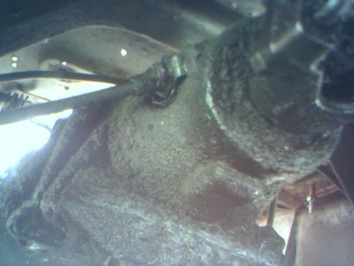

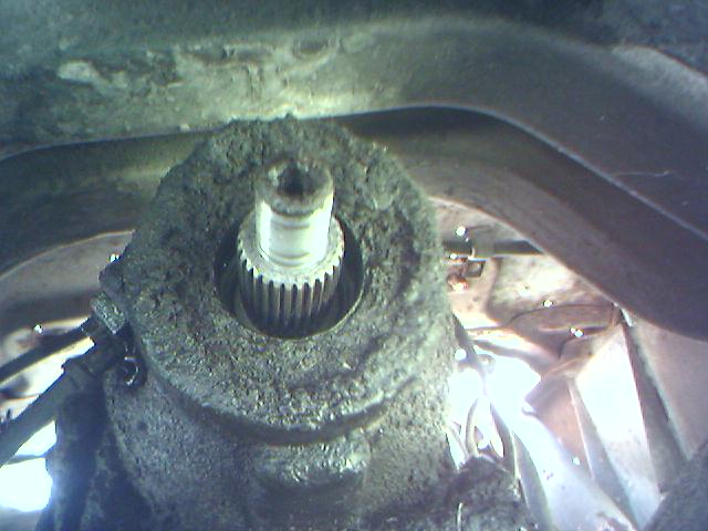

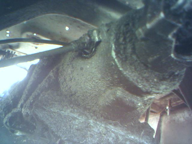

that looks like the tranny all right, it has a 302 engine. here are a few pics of the rear cone I took today.

Ranger Dave, that looks like the tranny I have. what the heck do I have?

Wow, that thing needs a good cleaning. Seeing that it is an RV, I would say it is most likely a C6, a c4 would come apart in an RV, and it looks like the tailshaft you have is longer than the tailshaft on the C4 rangerdave showed. Look at the bellhousing, it is removable on a C4, but integral with the housing on the C6 (nonremovable).

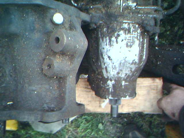

well I Don't know what the heck, the C4 to dana 20 adapter I have will bolt onto the back of the tranny. It even looks like the output shaft on the tranny is the correct length, except it's threaded on the end. the dana 20 looks like the spud shaft has room to accomidate the threaded portion but don't know for sure.
my dana 20 adapter next to the output shaft cone

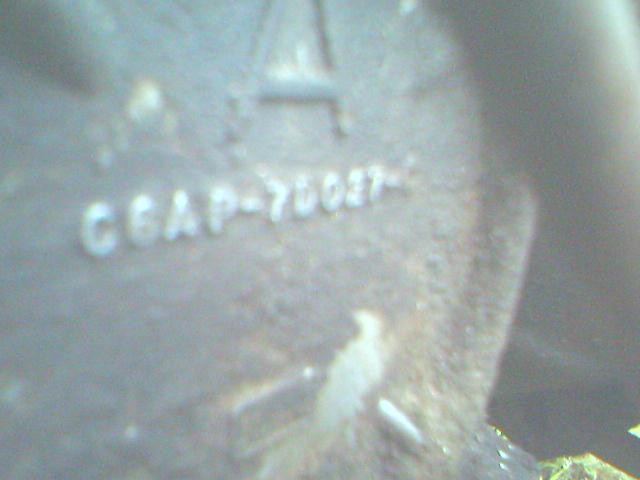

looks like the number is: C6AP-7D027-0
trans number.jpg (26.2 KiB) Viewed 7889 times
looks like a C4 to me.Is that a F250 truck??. If you dont use the D20 adapter i might be interested

do I have to have the threads cut off? this tranny is out of a 1973 ford rv with a 302 engine
How many splines is the output shaft?

output shaft has 28 splines, it's a 73 Ford RV. I thinkg it may have been something like a E-350 or something.

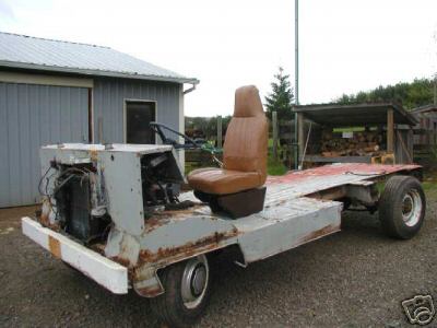

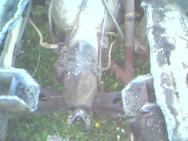

this is what the 73 RV chassis looked like when I got it
by the looks of the rear axel its at least a F250.Does it have 8 lug wheels
