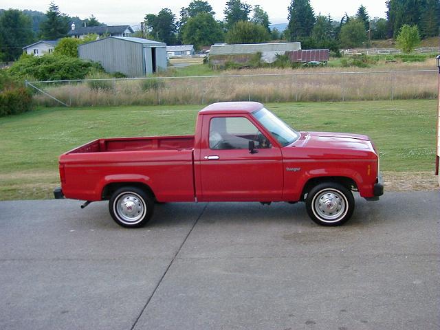

I bought this Ranger a while back with a blown up 2.0, it has 81,000 original miles. I have a, never fired Bliss performance roller 302, and T-5 Hmmm...... What do you guys think ?

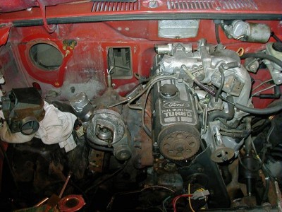

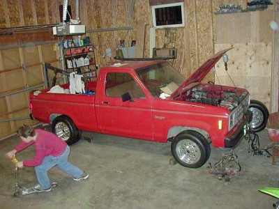

Well I yanked the SVO engine, and have let the truck sit for some time now,
the kid in the picture is 6'-1" tall now, that's how long its been.
Sleeper is the way I would like to go, this time.
How about this scenario, I have a set of the 15" Bronco2 rims that take the little stock hubcaps, I would send two down to Stockton Wheel and
get them widened to 8" for the rear. I would put the end of the stock tail pipe back up under the back with a bracket at the top to hold it, it will be connected to nothing mind you, just a dummy pipe. I would run 2-1/2 exhaust just
over the 9" and stop it just out of site. From the side it would appear all factory ! I will leave it at the stock ride height. IMO most rigs look good lowered but for some reason I don't think Rangers look good at all lowered.
Their fender wells look funny or something to me. Being a sleeper, the stock height would be the way to go.

The SVO motor powered the Ranger very well. It was almost a bolt in, with the exception of notching the heater cover and relocating the battery for the vane air meter.

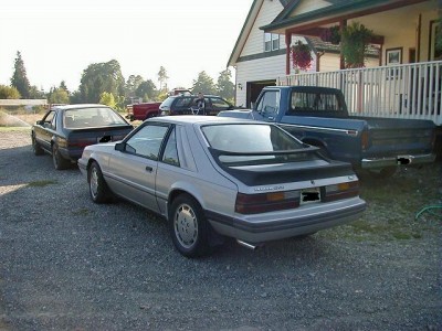

I used a Volvo intercooler,1986 PE computer, ATR stainless header, brown top injectors, (can't remember their LB now) the bigger 86 VAM and a gutted upper plenum. I could never get the thing to run correctly 100% of the time though, It always had something quirky wrong. I pulled the motor and sold it along with two SVO Mustangs a couple years back. I also had a Pinto with an SVO motor, rolling up a Vette or a Camaro with a 4-cylinder Pinto was fun !
