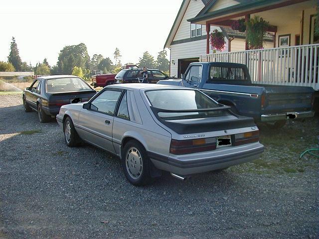

Well I yanked the SVO engine, and have let the truck sit for some time now,
the kid in the picture is 6'-1" tall now, that's how long its been.

The SVO motor powered the Ranger very well. It was almost a bolt in, with the exception of notching the heater cover and relocating the battery for the vane air meter.
I used a Volvo intercooler,1986 PE computer, ATR stainless header, brown top injectors, (can't remember their LB now) the bigger 86 VAM and a gutted upper plenum. I could never get the thing to run correctly 100% of the time though, It always had something quirky wrong. I pulled the motor and sold it along with two SVO Mustangs a couple years back. I also had a Pinto with an SVO motor, rolling up a Vette or a Camaro with a 4-cylinder Pinto was fun !
Emissions testing may be why we don't see more V8 swaps. I am lucky
Orting is exempt. I'm sure that will change soon though.

I think SVO's are the best of all the Fox body mustangs. You could do 140 mph and get 22or so MPG. 5 lug 4-wheel disc and a 5-speed. They will out handle the v-8 models. To bad you would fall though the floor.
