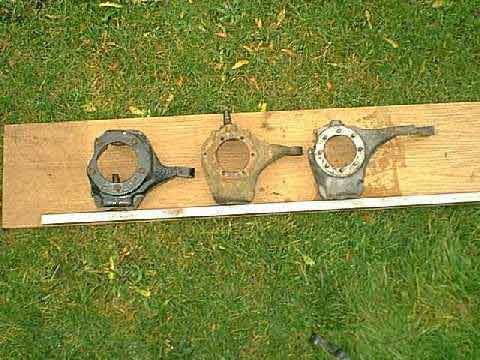

Yes, you will need a reamer. One of the tie's needs to be reamed so the drag link can connect. It's also a good time to ream the knuckles from the top so you can flip your tire rod.
Even better, get yourself some drum brake knuckles, since they have a higher steering arm (center). Of course then you have to do the chevy disc conversion.
I agree with Nobody, if you are running the ford disk brake stuff on the D44 sell your knuckle out to an EB guy who just cares about the disks and go with the EB knuckle and chevy conversion. the chevy TRE conversion is a good reliable setup.

i have the ford discs on it now, couldnt find the chevy spindles for a good price. i still have the eb knuckles though.
