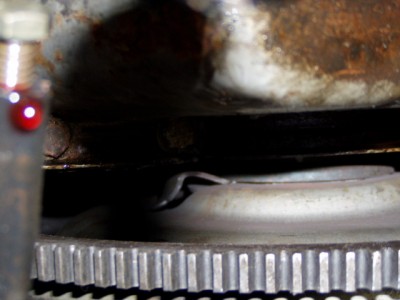

Yesterday my son and I put another starter in his 84 B2 and it still makes a bunch of racket when engaged ? I checked the ring gear on the flywheel as close as I could with a mirror, the teeth all look good. I wonder why it makes so much noise ?
If it's an automatic, check the flexplate for cracks.  My 85 started making some racket.  I thought it was just loose starter bolts.  It steadily got worse.  Finally I tightened up the starter bolts, which were loose, one was actually missing.  The noise never went away.  Then it dawned on me that I had actually heard that sound before...so I check, and sure enough the flex plate was cracked.  My was pretty severe.  It doesn't have to be as bad as mine to make a bunch of racket.
						look to see if the spacer plate is in between the motor and tranny.

Come to think of it, I don't think it does have the spacer plate between the
block and bellhousing. Its has the manual OD transmission. I could probably put a temporary shim between starter and bellhousing to test it.
