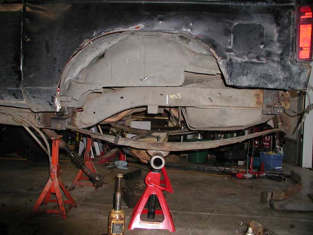

Well, you can get lift in the rear for almost FREE. All you have to do is build new spring hangers. I'm using stock fullsize Bronco springs in the rear with home made hangers. I actually sold off my skyjacker 4" leafs because this was better.
In the front, you can do a solid axle swap, including axle for less than these lift kits go for. I'm all about keeping wheelin affordable. All you need an axle, coils springs, and some radius arm brackets.
