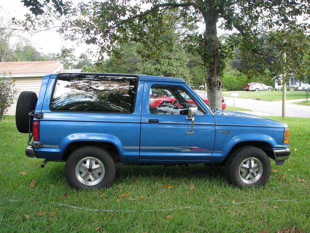

I bought a 90 B2. Prev. owner said engine was knocking so he had it rebuilt, put new tires on, and painted it. I got the truck with a trans problem. Trans would go into 4low (not 4 hight) with the button in the dash but you would have to take the transfer case off and put it into 2wd manually. With that being said. I don't know if the problem is in the engine or lack of experience with the B2, but it is the SLOWEST vehicle I have ever had. including my 88 ext. cab, long bed, f150 with dual tank etc. This b2 has no pick up, takes forever and a day to get to 60 and gets about 12 mpg. Is this common in this type of vehicle or can it have something to do with the tranny? or the rebuilt engine. ANY advice would be helpful.
Pic of the overall truck right side.
Believe it is a 2.8
Believe it is a 2.8
