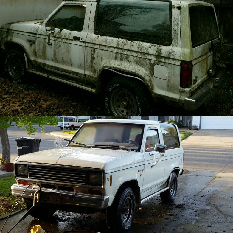

There it is as it stands ha, needs a new motor, been thinking hard about it, and found a 94 manual 4.0 for $400 seems like its getting a swap

She looks rough, give the ole girl a scrub down, I wanna see what she really looks like

Now find out how to pop open the hood since the pull cable seems to ve broken and see what happened to the engine ha

Looks real nice washed up

That's a right nice looking rig? She cleaned up real good. :cool:
