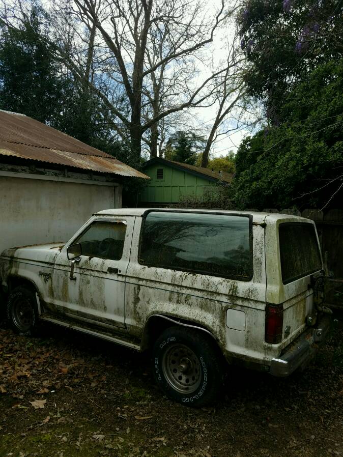

Mer925
Posts: 11
Joined: Fri Feb 17, 2017 10:42 am
Location: Northern CA
Re: 1st B2 Build
Post by Mer925 »
There it is as it stands ha, needs a new motor, been thinking hard about it, and found a 94 manual 4.0 for $400 seems like its getting a swap

offroadohio
Posts: 144
Joined: Sat Feb 12, 2005 2:50 pm
Location: Roseville, Ohio
Re: 1st B2 Build
Post by offroadohio »
She looks rough, give the ole girl a scrub down, I wanna see what she really looks like
