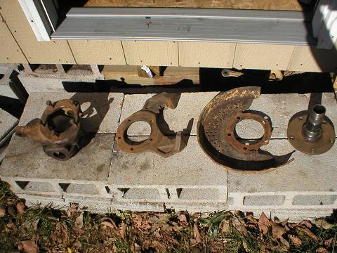

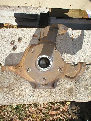

ok, I beat the ball joints out and cleaned everything up and its all ready to paint. here are some pictures:
first pic is how it goes together from left to right knuckle, caliper bracket, dust cover, spindle

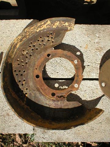

this is the part I am going to toss:

you can see the dust cover is pretty ate up from rust. when I had the spindles off before to install the 5.13s in the other housing I just left the caliper bracket on the spindle and did it that way, so I had no idea it was as mangled as it is.
I can see what you were talking about that the caliper will adjust itself out, so you think it will be ok?

That looks similiar to the dust shields that came on my '77 EB disk front end, but I don't think mine had the vent holes. Mine were rusted and mangled so I tossed them w/o using any spacer. No problems in my case.
