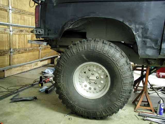

i run 33x11.5's on a 15x7 rim...not sure on backspacing. they are the same rims as nobody shows in that picture....well heres a picture. the only sort of rubbing i can find so far is my tie rod on the diff cover at full lock (left) :laugh: as for axles i have a 31spline 8" in the rear and 297x D30HP up front...and lots of spare unit bearings if needed. 7.5 should have no problem with a wide tire or rim...but ive heard the Dana35 might not like it. i know NightKrawler runs some 12.5's on 15x8s and claims to never had problems.
