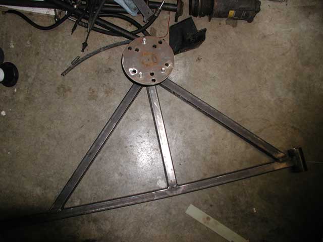

How many bolt patterns do you have on your truck, on mine my rims and axles limit my bolt pattern to 8 x 6.5. Sorry I'm a smart ass much of the time, but since you are probably talking about axles swaps - a 1/2" drill bit and a couple of 1/2" fine thread bolts will change the bolt pattern for you. Just cut 2 of the old bolts off and drill for 2 more , put the bolts through and tack weld them on the back where you need them for the new bolt pattern. The thing I don't like about either one is that you are limited on the width and offsets, cause they didn't reach the mounting surface of my rim, but I fixed that too. ;)
I actually ran with 2 different bolt patterns for awhile, not that I recommend it or anything though.

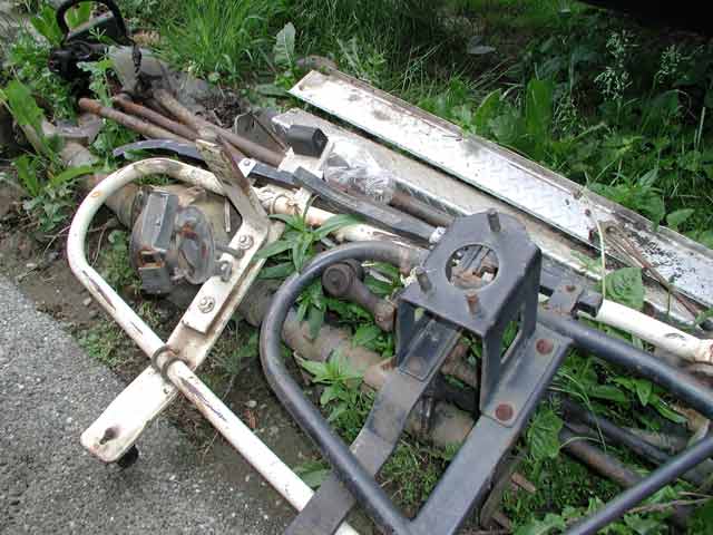

Here's a pic of the 2 different styles. The tan one is from a full size bronco though. My original Bronco II carrier was that style though.
The one I built uses a plate that drilled for all the popular patterns.
