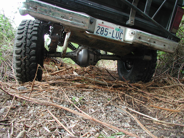

The chevy springs are 2.5" just like ours, I don't remember what year exactly but they were early to mid 80s chevy half ton. The brackets hold it a little bit closer to the frame, but my shackles are made to compensate as you can see in this pic:
Here's one from the side to see what the hangar does for me holding the shackle about 2 inches below the frame instead of at the top of it:

On the front hanger, I drilled out the lower rear hanger hole and ran the spring bolt right through the frame. On the rear, I made the top shackle bolt just below the bottom of the frame. I used existing holes in the frame where possible. This setup moved the axle back 2 inches. You could always change the hanger positions for different axle placement.
Quite surprisingly, moving the axle back 2" saved me from having to shorten my driveline. Since the dana 60 was bigger, it was a perfect fit.

Are those the 63" springs? Don't seem that long. You're going to leave that excess shackle hanging down like that?

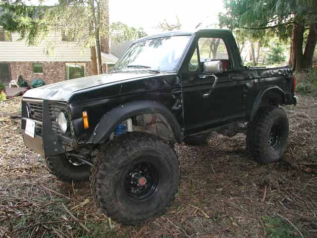

here is my setup...also note in the picture of my articulation im still about 3"-4" from maxing the leafs. my main leaf is a B2 leaf and i believe they are 55.5" because they were hardly shorter than the F150 main leaf.

84bronco2 wrote:here is my setup...also note in the picture of my articulation im still about 3"-4" from maxing the leafs. my main leaf is a B2 leaf and i believe they are 55.5" because they were hardly shorter than the F150 main leaf.
So you made a hybrid pack from Bronco II and F-150 springs?

yeah...i know what you mean. that was when i first started the project and only had 2 jack stands...first time i went to town for parts i got another set and ditched the cinder blocks. and yes..i made a hybrid pack with B2 leaf and F150 leafs. after entering all their specs in a spring rate calculator....ive only got a 187 lbs-in. spring rate yet a higher spring load which is why it flexes way more but also lifted me and supports way better.....not sure exactly how all that works but whatever works lol
