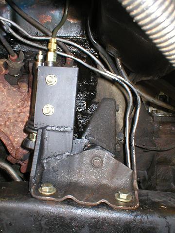

I couldn't do the type of bracket you did because of the motor I am running. the 351M is wider at the bell housing so there is not much arm extending past the bell. so I had to use the rotating part of the z bar setup and weld another bracket on that and mount the slave pointing down. My camera is hinding from me at the minute but I will post some pics when I find it. is there anything you could compare the stiffness of the clutch to?

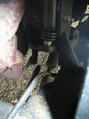

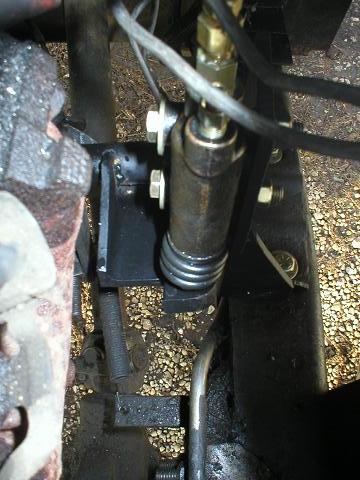

where are some pic's of the setup:
you can see that as the slave pushes the bracket rotates and actuates the fork. it works well, and you even have some adjustment with the rod that connects the bracket and fork.
thanks, I thought about it for a long time before I made up my mind on how I wanted to do it. it just seemed like the most practical way.
