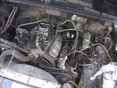

You will need the 2.8 engine harness and ECM. Depending on what year it is it should plug right into the body harness. I found that removing it all and running a Mallory Unilite distributor cleaned up the engine compartment. :D Also you will remove the rev limiter with the dist. The carb will work without being hooked up to the computer. Though I used the carb off of a 77' crapi. I will agree that I like the 2.8L better to. It is a little more maintenace due to the solid lifter cam but it was way more fun to run especially at 7000 rpm :redneck: .good luck I attached a picture of the 2.8 with the Duraspark II ignition. It work well but it failed over time and still had a few wires involvedas you can see. :redneck:
