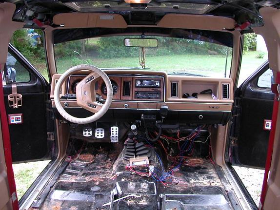

First step: move all electronics higher. On some BII's there is a computer in the rear panal on the passenger side....what it does I have no idea but you need to move it up so it dosent short. the ECM should also me moved from the kick panel in the front up into the dash. ford computer can see water from a mile away and they will fry. they are very sensative to this so be warned.

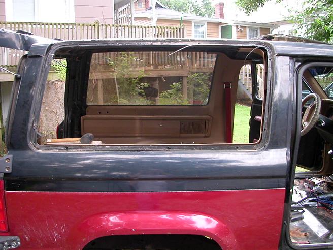

second step: remove windows. on some they can be unbolted. others have to be cut. even if you unbolt they still might need some help....be carful, remember what I said about safety.
third step: gut interior. even take out the seats. I caught the back seats on fire when I was welding the roof back on but I couldnt get them out so I left them to be cut out later, but I am lazy and now they are mildewed so I need to get them out.

measure everything one more time and start to cut out the supports. I went to the roof supports first, then I cut the rear pillers all at one time. the rear pillers look easy but they are thick make sure your blade is long enough to go with out catching and kicking you out.....this will just make you mad and want more beer in your system. you can use the welder to cut but it is sloppy and will warp the panals. a grinder works well but it is slower.
after you get the supports out and the rear pillers cut you are ready to go across the roof. have someone hold up the roof inside the truck away from where you are cutting so the roof doesn't fall and hurt you(i.e. landing on your foot). mark your line and fallow it across the roof with the sawzaw. now help your friend lift the roof off.

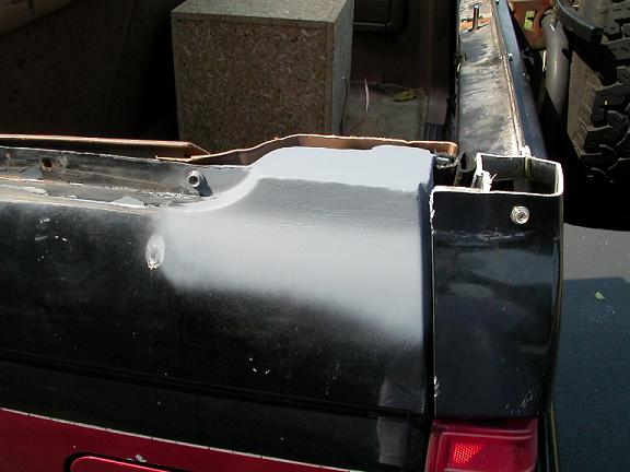

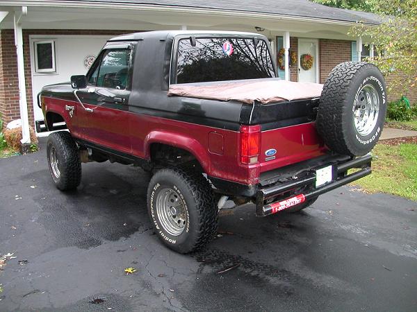

step five:
because I wanted to be "different" I cut the center section out of the roof I just removed and welded the suports back together minus about 2 feet of roof. this made it look like an extended cab ranger......but I also reinstalled the leftover of my hatch to the back so I can reach back and push my rear windo up to get the converable affect. I have busted one window but one in 2-3 years? works for me. I then welded in a flat piece of metal to the rear piller to stop it from filling it with water mud and anything else that might get in there and try to make a home.
step six:
now that you are done cutting and welding in panals. step back and look at your new truck and how ugly the seams are..........go get some bondo or filler of your choice and fill the seams after you grinding them down. then shoot the exposed area with some primer and paint. I like to use flat black because it stands out less and shows less imperfections. but if you like purple or green then go for it.
