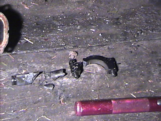

ya i gotta say i dont like the 7.5 to much..its cost me way to much. first i broke the spyder gears, then i welded the gears together and broke and axle. then i was given a detroit locker and a new axle shaft. now my 7.5 is worth nothing but something to keep the rig off the ground. destroyed the gears, broke driver axle shaft, twisted passenger axle shaft and broke my detroit locker in the process. i ditched it and now have a 59.25" 8" axle. all this was done with a mild 2.8 btw :wtf:
