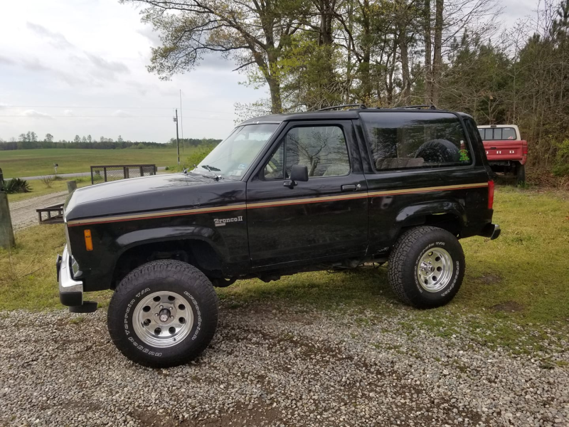

This weekend, I will be looking at a 1988 Ford Bronco II 5 speed manual transmission from a family friend (that i dont really know all too well)

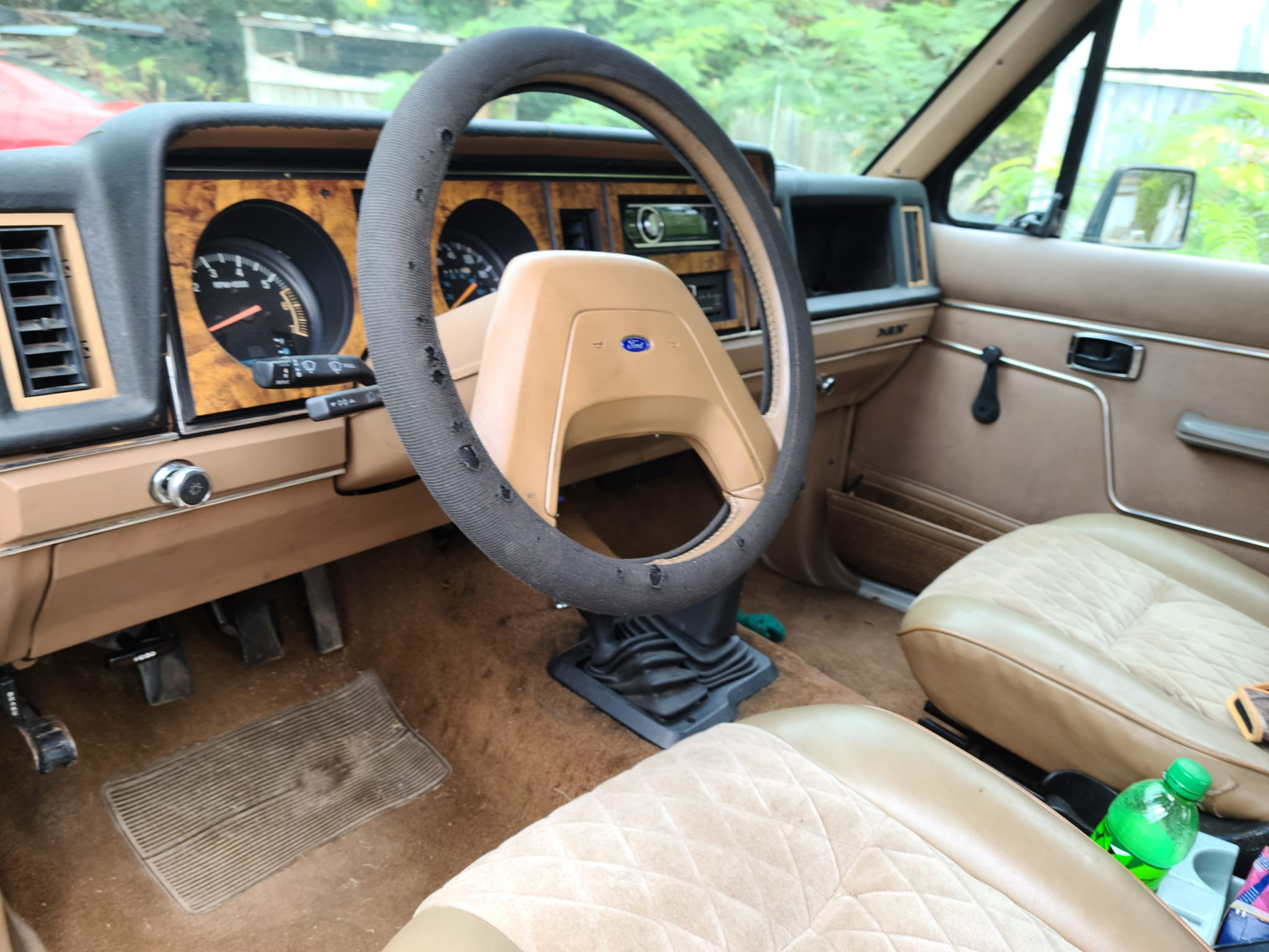

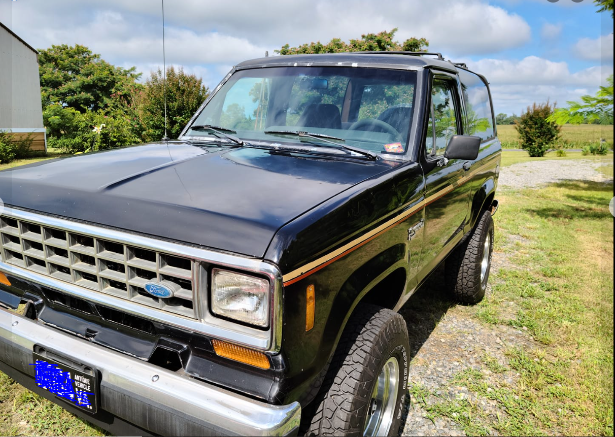

In any event, he is asking $1000, so its definitely worth my time to at least look at it! He states there are no major issues/issues he can think of, and from the pictures (pictures mind you), the paint looks to be in decent shape, and I dont see any rust spots. The interior didnt have many pictures, but thats fine, I could see through the windows it at least had all its seats. He even has the tire on the back swing door as well.
Now given he states there are no issues, I obviously am skeptical, and I don't want to press without seeing the car first since he is asking only $1000, and I dont want to spoil good graces if it is indeed pretty cherry. Nonetheless, I am curious what you guys (experts) recommend that I look for, common issues, etc. I have been reading on here about the related. What should I check for? Look for? Besides all the working basics. I am curious what the condition of the undercarriage looks like, so I'll get to that first.

Thats a nice looking BII. I see quite a few positives to it. It's a stick with a manual Transfer case. It looks clean. If it runs good I would jump on it in a minute. It has nice wheels and room for bigger ones with the body lift it has. check the water level in the radiator and if it is real low there is the possibility of a cracked cylinder head. 2.9's are famous for cracking heads if they ever overheat. the 2.9L motor is noisy with a lot of lifter and injector noise as the injectors are mounted to a tin type injector housing. If it checks out you would have a good little rig.
