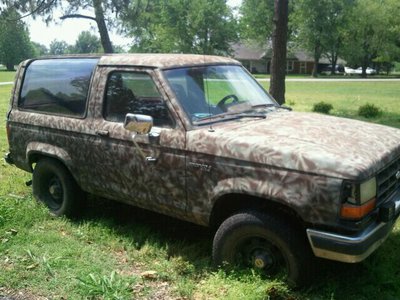

1990 b2... its cute! no?
Okay I love my b2 but its been turned into a shop truck for now its a good parts runner and you can fit 2transmissions and it has been proven to haul vehicles on the car dolly so my prize? A new b2 and camo too! Bwahahaha but its not 4wd :( oh well... I still like it

You could drop a dana 35 up front and a manual Tcase and you would be back to wheeling. for that matter a dana 28 for light wheeling It would be a nice weekend project. BTW Nice Rig..

Wait a minute.. I am confused.. You just got the camo B2 correct?
The camo rig isn't 4X4? I was looking at camos' front hubs and they are manual locking type correct?
Wouldn't that mean the camo one does not work in 4X4?

Nope those are center caps on front and rear
Re: 1990 b2... its cute! no?
Lol yes the boys at the shop have taken over the brown b2 that is 4wd this one I found lurking on the web and wanted to get it for a shop vehicle to get my b 2 back no go what we may look into is swapping the front end ? See if it can be done if it can we will do it... Maybe I can ask you guys...

Yes it is doable
I've seen rangers on b2 frames so same concept right? Humm plotting I am

If I remember correct the front suspension uses the same mounting brackets. And just yank out the dummy t-case and install a real one.

Easy conversion everything bolts right up

You do need to change the frame brackets on the left front. Just use the one from a B2 4X4.
I have done it before and it is not rocket science. If a broken up old wheelchair riding biker can do it anyone can.

talked to hubby and boys at the shop we normally have a slow down around November and i got the go ahead from the hubby... so come november franken bronc project will start
