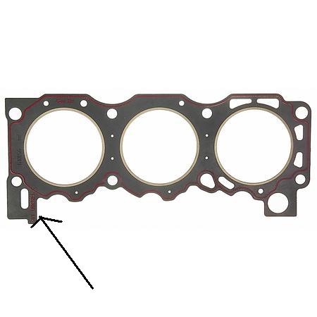

must be the unlucky one who has found ones that dont say then.. all i need is a decent pic of one showing which way it goes or the markings on them and i will be sorted

this is a 3.0 but there all marked
