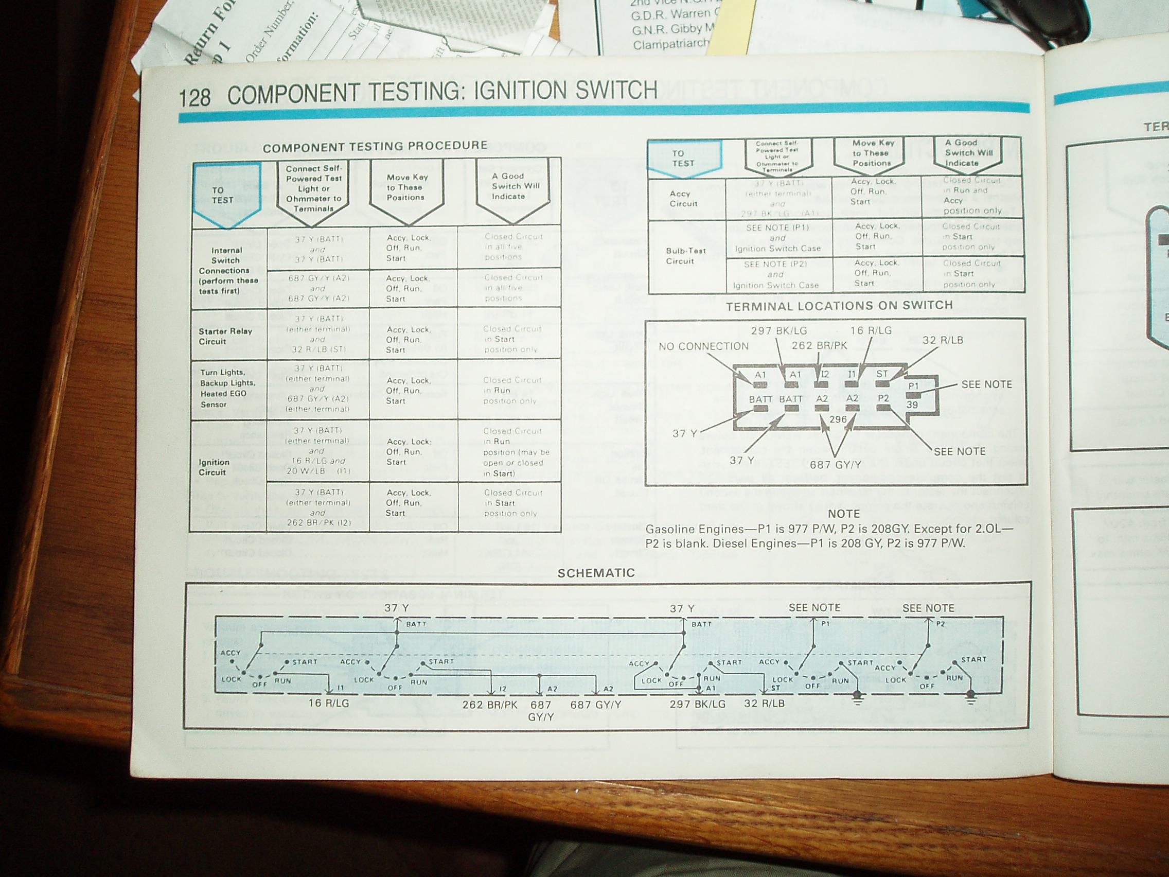

The engine dies if I don't keep the key turned forward. Any ideas on what causes this and/or how to fix it?

Could be a Ignition Switch
