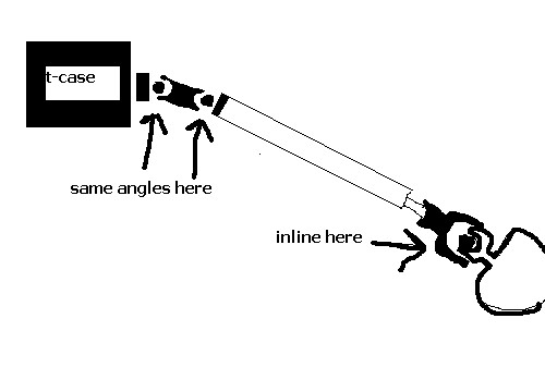

Need some help. Hit a few piles today to check flex. I've still got the "revolver shackles" installed. They're coming off, they suck! My question is, when I got home, I noticed the u-joint retainer bolts on the rear end were bent from rubbing on the slip yoke. I set my caster angle at 17 degrees with about 4-5 inches of lift. If I remove the shackles, am I cured?? Here's a pic of my set up. Double cardon @ t-case.
drivline angles.JPG (19.42 KiB) Viewed 5427 times
i remember reading in one of my 4wheel mags that you want to have a both end's at a angle. the top look's good but the bottom should probabaly be at a lower angle (tilted downward).

Cool, thanks Wilber, My setup looks right. Bye- Bye POS shackles!
