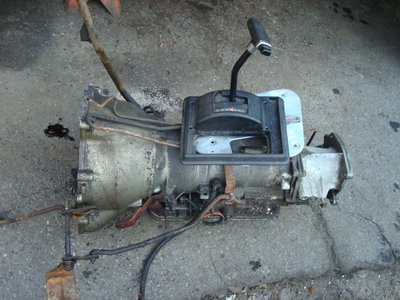

I removed the A4LD automatic from my 85 B2 and have the FM145 in now. I need to disable the neutral safety switch for the truck to start with the key and I need to ID the reverse light switch. I found 2 plugs yesterday, one with about 5 wires going into a round plug and one with 2 wires going into an flat plug.

the round one plugged onto the tranny, should be able to cross a couple of wires and make the backup lights come on, and cross two more and have it start. just which ones i donk know. the other plug is for the lockup

Thanks Rangerdave. You just saved me a lot of trouble.
