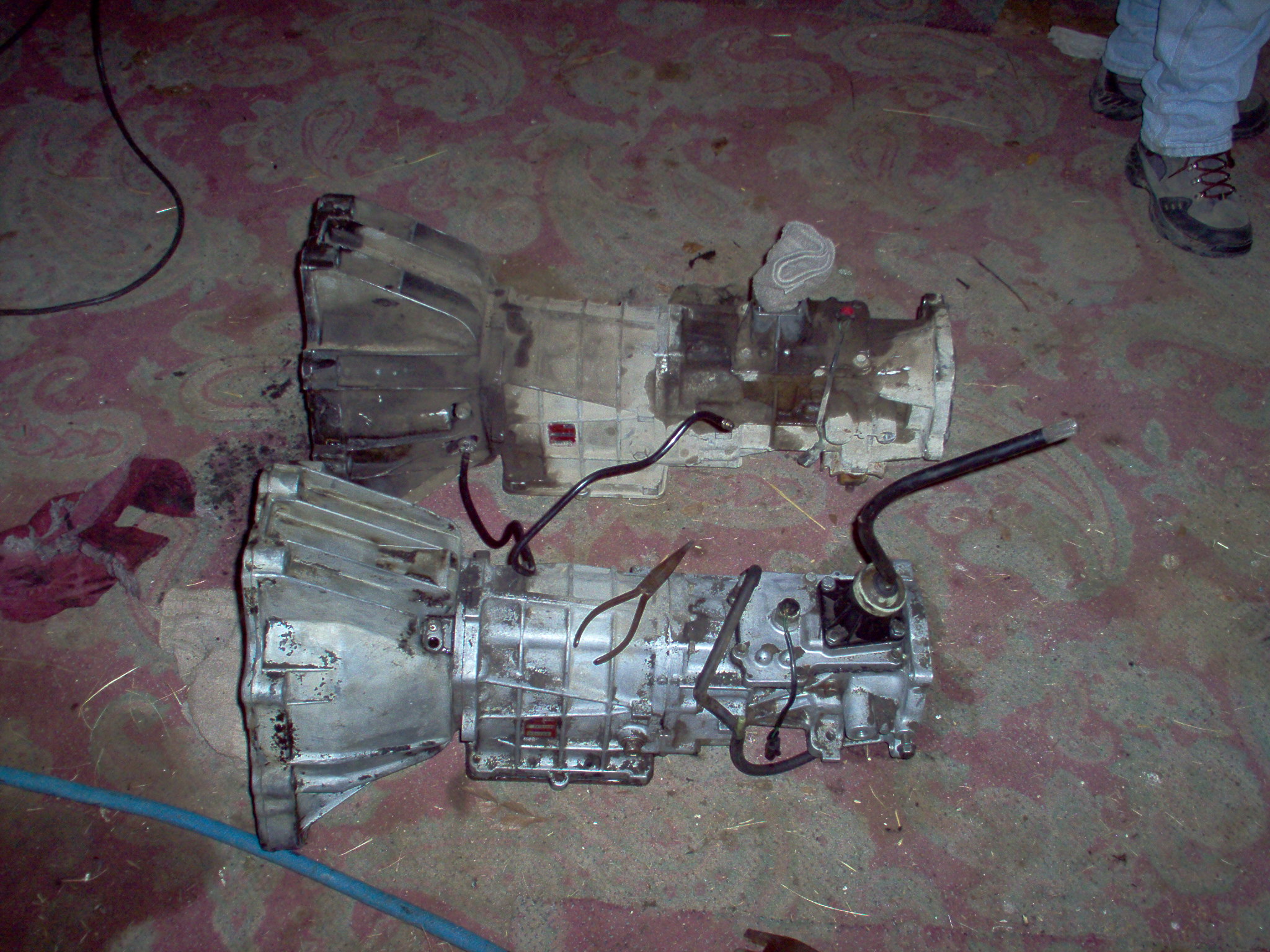

the mount didnt line up cause i went from a FM145 to a 146. the 146 being longer
also in 88 the auto and std trannys are the same length

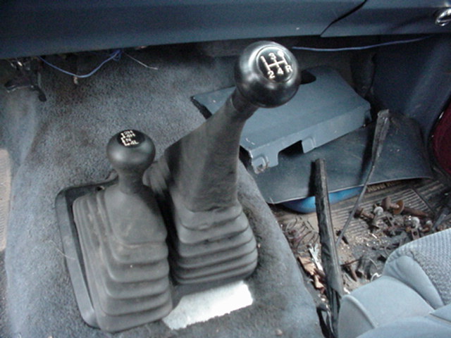

what does the shifter look like?
Bronkitis
Posts: 16
Joined: Sat Feb 06, 2010 9:05 am
Location: Spanaway, WA
Re: Front Driveshaft Dilemma...
Post by Bronkitis »
It's the tranny on the bottom with the nuetral switch directly in from of the shifter
than someone changed it. it should have the one in the bottom pic which is the top one in the top pic

Someone changed it from an automatic transmission to a manual transmission. This I know. The tranny they chose for the swap is the bottom one in the top picture. Which transmission is that? Will have pics TONIGHT!!! That will help explain a lot ;) Thanks for all your help
thats the FM145.

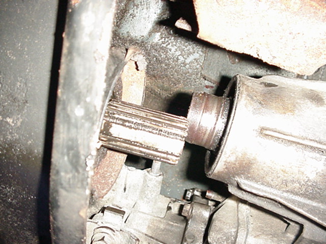

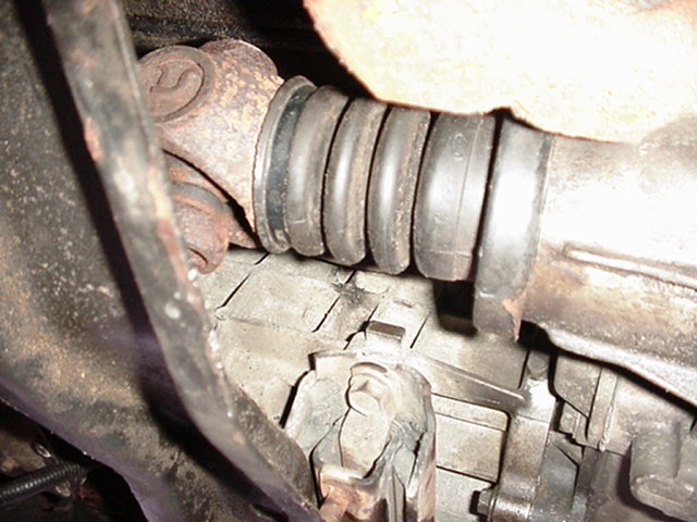

Ok, just got under neath and retried installing front shaft. Voila! Got it in only to realize it's about 3" too long... Dang!
Which shaft do I need then....? Am I stuck shortening the one I have or can I use one from a BII that had the FM145 stock?
No pics tonight... Camera died first pic I took and I aint crawlin back into my truck again! lol
