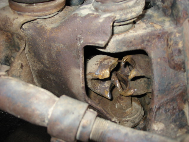

check the u-joints

doesnt make any difference if its a ford,chevy,jeep ect,they all have um,

But Yeah, Thanks For That Pic!

Thats a good picture Dave, I have seen a couple do that.
