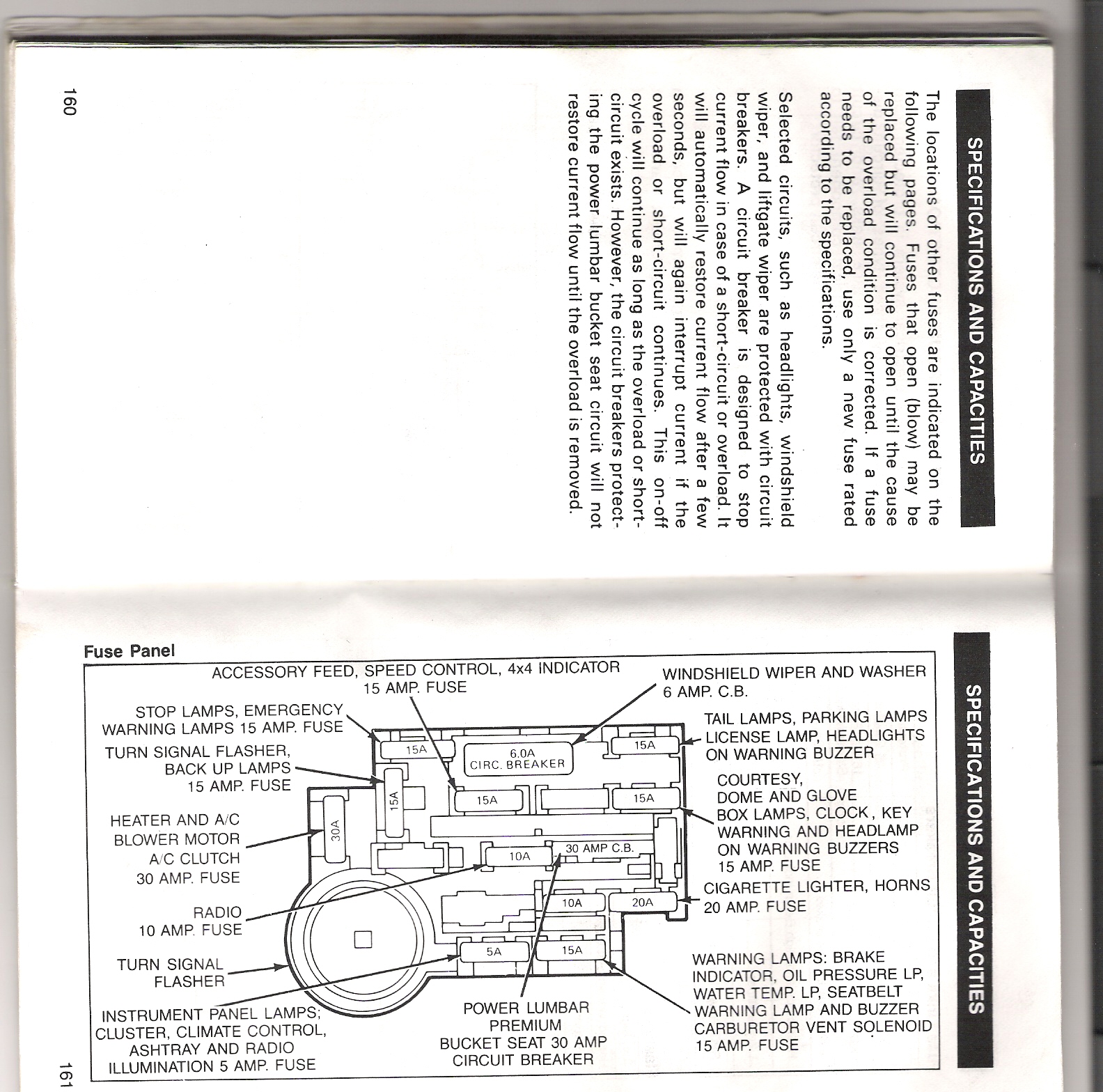

i need to know where to find one. i need to know where the taillight fuse is at in the fuse box.

upper rt. hand corner. its a 15a. the one on the left is for the brake lights anf flashers.
