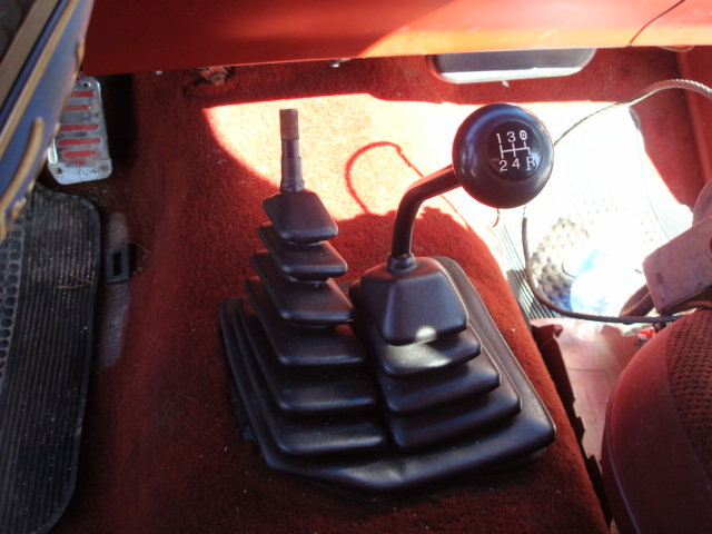

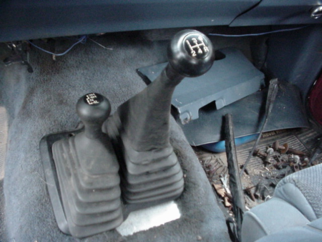

Re: B2 driveshaft
this is the 146
and the 145

i got a 89, thanks for the pics. i have the 146
