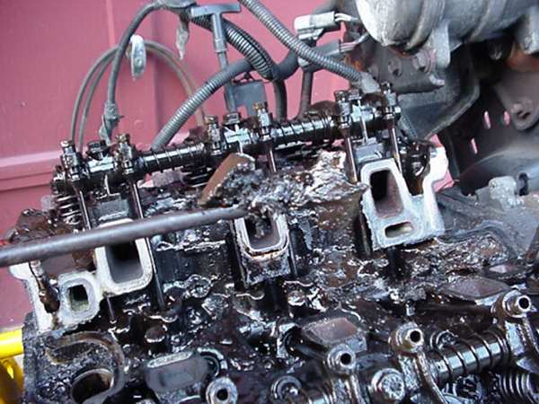

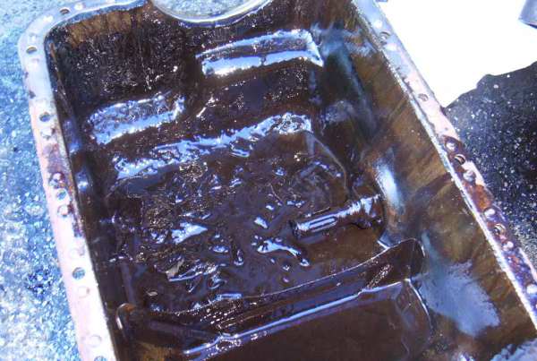

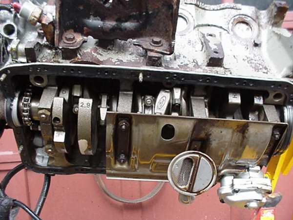

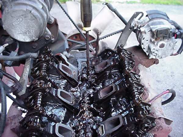

If you are not the original owner it is hard to tell how long between oil changes and what oils where used. Had the same problem on my 89 Ford ranger about 8 yrs ago and on a number of rangers since then. My family owns a small sized Ford Ranger salvage yard and truck lot and we have ran across almost every problem out there. We have bought around 350 Rangers and B2 in the past 10 yrs and sold about 2/3 of then on our car lot. But to answer you question this is your most common problem, your oil sump screen in clogged with oild globby oil. When the truck is shut off oil slowly seeps into the sump and pickup tube. Upon start up you will get perfect oil pressure to the engine but once you rev the motor up above idle it sucks all the oil out of the sump and pickup tube and can not get oil threw the sump screen fast enought to keep up /or catch up to the oil needed to properly lube the engine. I few different options can be done to try to cure the problem pryor to the bigger job of pulling the pan and replaceing the sump and pump. Option 1: drain all oil from pan, flush a qrt of deisel fuel threw the engine to remove and honey like or globby oil. put the drain plug back on the pan then put 1 Gallon of diesel fuel in. Let it sit over night to soak , remove oil drain plug and drain diesel. Watch to see if any globbs of oil come out with the diesel, it is very important NOT TO START the motor with diesel in it. Flush engine with 1 QRT oil, replace drain plug, put in new oil to properly fill engine. If it fixes the problem you need to change the oil again in a about 1 tank of gas to remove any left over diesel. If does not fix here is Option 2: A little more tricky and you will need a windshield washer bump, 8-10 ft of wires and a few feet of small rubber hose. OK drain oil, pour a little diesel into a plastic bowl. take the windshild washer pump and attach the hose to the outlet tube , attach the leads off the wires to the washer pump and to your battery makeing sure to have good connections to prevent sparks, drop the pump into the bowl of diesel fuel and stick the rubber hose into the drain pulg hole and move it around inside the pan for a while or untill you have located the sump. Try your best to clean the sump screen off by running diesel threw the hose. This may take a little while and when you think it is probably clean enough keep cleaning and flushing oil pan. After a long time doing this then rinse out the pan with the rubber hose with diesel. Replace drain plug and fill oil. To save your diesel place the bowl under the drain hole so you recycle the diesel and don't just wast it on one shot. Again if this fixes the problem change oil after about one tank of gas Option 3: Replace the sump and the pump. Option 1 and 2 are try at your own risk. We have never had any problems out of these options but again there is a first time for anything. We have done option 1 a number of times with an 80% victory. Option 2 is a last ditch effort after option one has loosened the oil deposits and has had about a 30-40% victory. Option 3 has had 95-99% victory Hope this helps and let us know how it works for you.
Re: Oil pump

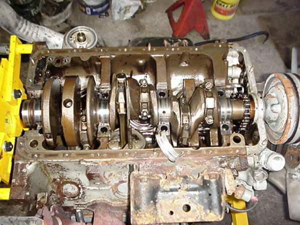

i dont think diesel fuel would of helped here. and it never ticked. i put new rod/main bearings and oil pump in it and it ran sweet

pour diesel fuel in my engine? WTF? lol I'd have to see it be done. Sounds crazy. The motor ticks pretty bad on the top end after driving 40 miles down the expressway at 70 mph. When I'm offroad it doesn't tick at all.

I have seen oil slim pretty bad but that was BAD. Yeah diesel fuel won't fix that. Deisel fuel will not fix all problems and is not also the best way but it sometimes is the best way if the problem is cought fast enough.. It is really hard to pin point the problem over the forums and it could be any of the problems the other members are talking about. I just thought you might try this before you spend a lot of money rebuilding a 2.9.
