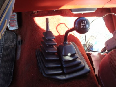

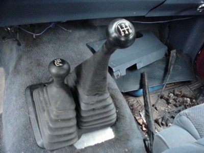

your 88 should have the Mitsubishi FM146 12 bolt pan and syncro reverse. the fm145/146 have the lowest 1st gear(3.76:1]
the 4.0 M5OD has a 3.40:1 first gear. look for a 88 and up.if you get a fm145, get the driveshafts too,cause that tranny is shorter,and youll have to move the crossmember forward
1st pic.146 shifter(the M5OD looks just like it)
2nd pic. 145 shifter
