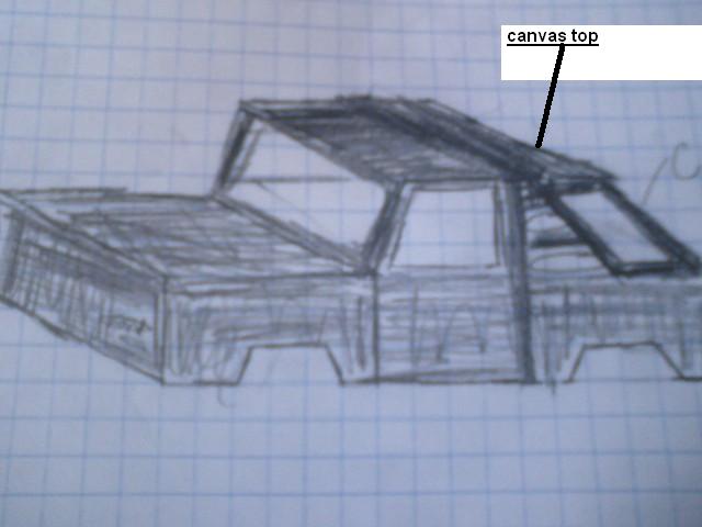

ok I've been making some decisions over the past couple of months, since i cant really off road around here in the winter, and i did some much needed body work on the B2, like fixin some rust spots in the floor boards. but i also decided to but just a 3 inch lift on the b2 and in when i get the time, baseball starts soon, i am gonna make a canvas top for the back of the B2.
This is just a rough sketch that i did while i was workin on saturday. but my best friend gave me the idea and i just added on to it.
