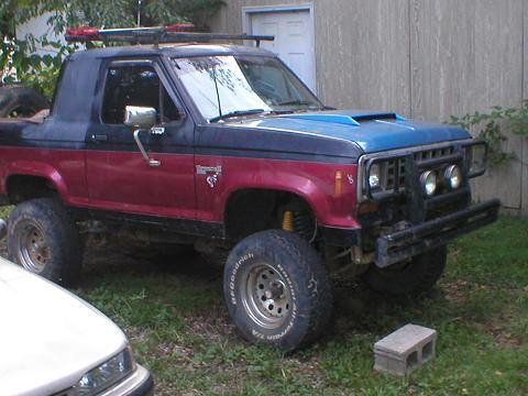

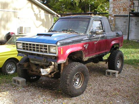

as it sits in the pic it has a 4.0L, 3" suspension lift, 3" body, 4.10's on-baord-air, rear mounted battery, extended stainless break lines, GPS, and a chopped top. basicly I just wheeled the pis out of it. now I am ready to take it to the next level. so right now I have it many pieces out back.
here is a pic of it before I tore it apart again:

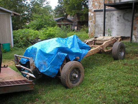

here is the frame and driveline I am planning on using for the BII. 79 FS Bronco. HP D44, 31 spline 9", NP435, 205. it has a 351M in it right now but I have a 302 form a couger I plan on droping in it. the EFI will come in a few months. also plan on setting up the 9" with a 3 link set up, radius arms and a track bar.
and here is the new home for the BII body:

just to let you know if thats a 351M your 302 wont bolt up to your tranny because the 351M run the big block pattern.
I found a SB bell housing for the NP435 in a field behind a friends house. even still had the clutch arm with it :redneck:
now that is some good luck!

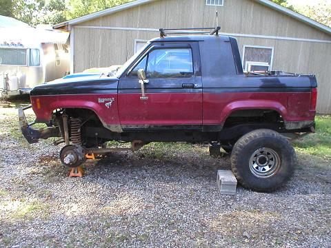

got the rearend setup.......next is the front and motor

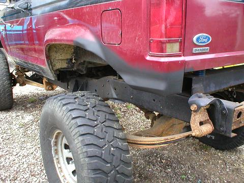

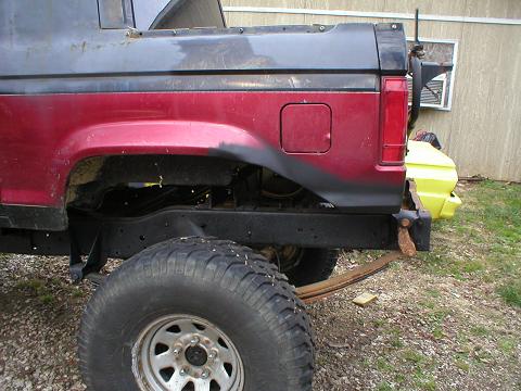

well, it is still early in the day and I already woak up my neighbors cutting and banging :laugh:
