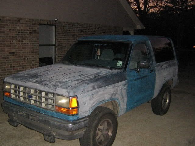

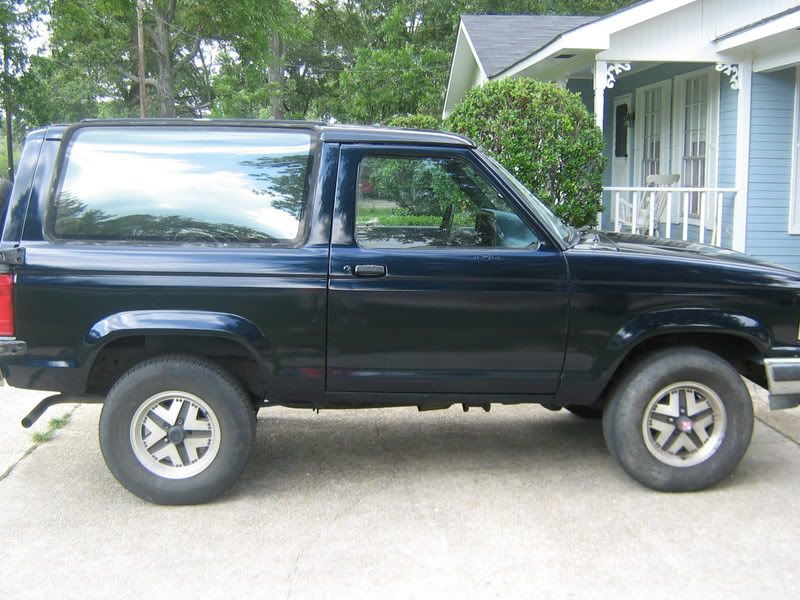

Also thought I would throw in some pictures of what im working with. This was a year ago in the process of painting it dark blue. I am going to repaint it viper blue after the axle swaps are done because I dont feel like buffing out the terrible orange peel.

and nice truck, great to finally see it. i like the color too !
actually i have been trying to pick a color for mine and i thought about dark blue but the trail scratches really show, but im not really liking the light color options.

I painted it back to factory color which was 7F dark metallic blue but the orange peel is so bad it would take forever to sand and buff it. This time im going with a lighter blue metallic. More of a candy color.
