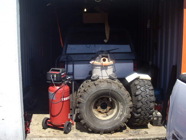

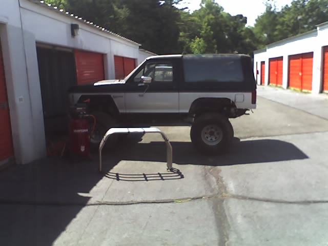

it has been awhile since i posted pics with my updates.
i looked for my last post but can't find it. these were taken about 3 weeks ago when i was moving into a new storage unit closer to where i live. it has a ton of dirt on it from being up on jacks for 9 months. here is what i have done to it
early bronco full frame
duff extended radius arms
dana 44 front 4.88's quick locker, disc brake conversion
rear 9" 4.88's with spool, 33 spline mosier axles
front 5.5" coil springs, rear 3.5" leafs with 2" blocks
all new brake lines
78 bronco p/s box converted for eb
99 chevy 3/4 ton hydro unit
saginaw pump
93 mustang 5.0 ho rebuilt stock
np435 with hydraulic clutch
np 205 t-case
super swamper tsl's 38.5x16x15's
still need to do-
fabricate core support- have new griffin radiator
finish cleaning up flare cut outs
run fuel lines
finsih efi wiring
reinstall interior
maybe chop of rear top

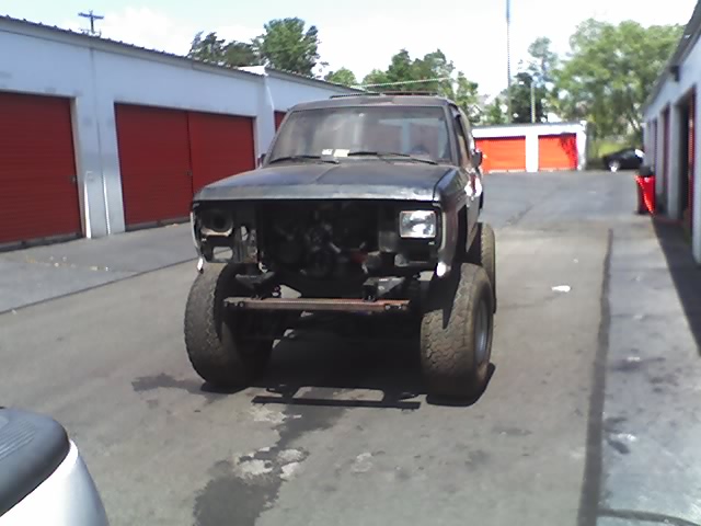

just for fun i included a few pics of the bronco when i first bought it for $150
and the pics show it sitting on 35 bfg a/t's but they were used to roll it around the shop it now has the super swampers on it

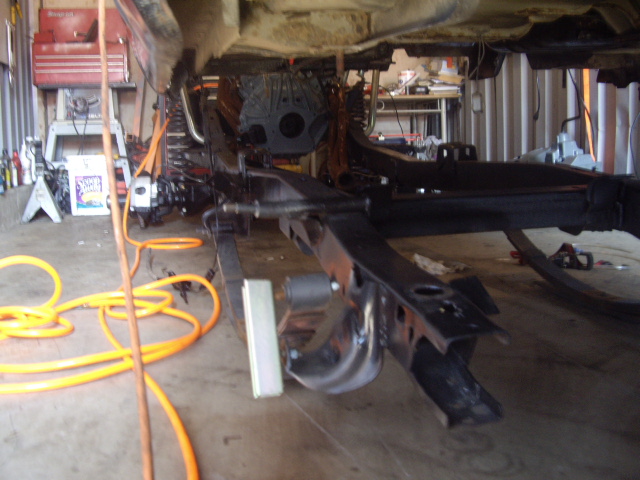

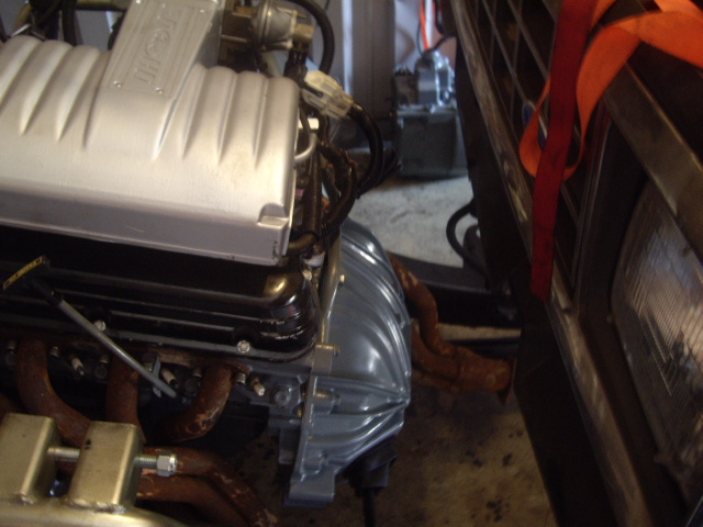

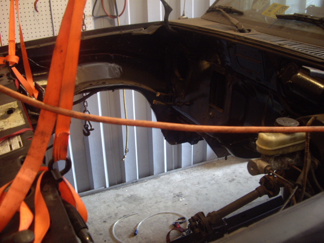

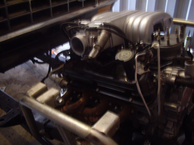

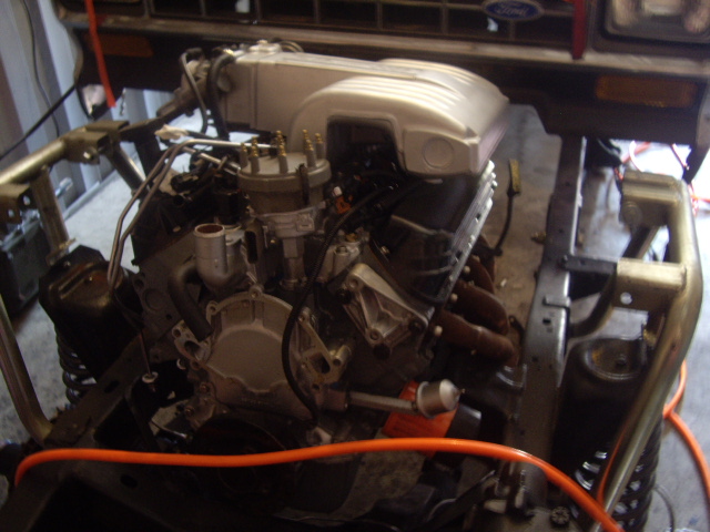

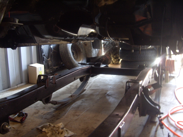

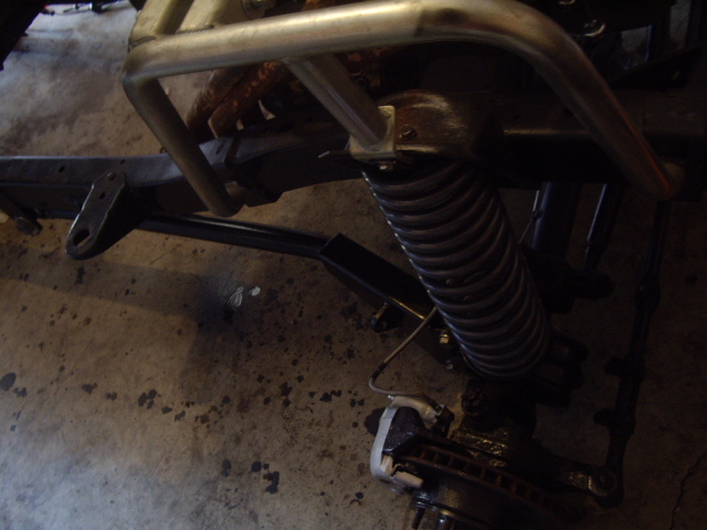

more pics of the build

Wow, well done, you guys don't seem to deal with the rust issues we do. I like the shock hoops, I hope to fab my own coil bucket/shock hoops in one. keep up the good work.

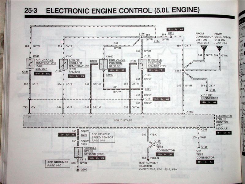

Re: vabronconut build
test
