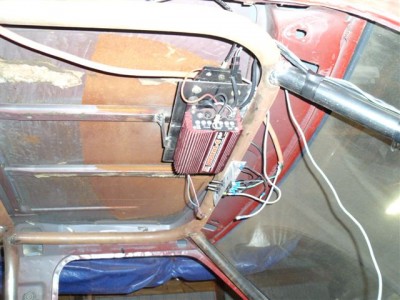

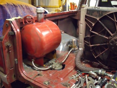

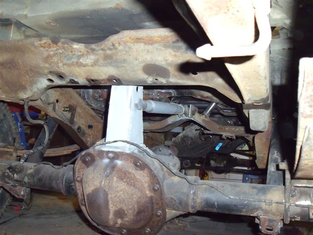

Hey guys I know its been awhile since I first posted this but do to other projects and obligations it got put on hold for some time now. I got back to working on it about 1 month or so ago and it is starting to shape up. As you can see I solved some of my issues like motor mounts and headers!

theres no way your going to be able to keep your rig cool with those small lines on your radiator. I run much bigger ones and a bigger radiator on my 351 with duel fans and it will keep it cool but when i had a bunch of hard 90 degree angles in it it would over heat.

Rockcrawler wrote:theres no way your going to be able to keep your rig cool with those small lines on your radiator. I run much bigger ones and a bigger radiator on my 351 with duel fans and it will keep it cool but when i had a bunch of hard 90 degree angles in it it would over heat.
Well I think it will, and we will soon find out. You must have a huge radiator because that is a 3" thick alum radiator( 2 -1 1/2" cores). The big thing is the truck is only gonna run long enough to drive from the trailer to the mud pit, through the pit( Hopefully in about 8-10 seconds!!!), and back to the trailer, maybe 5 minutes tops. what kinda pump did you run?

i run just the stock pump. buts more of a volume thing then a pressure thing. Higher pressure will just keep it from boiling. You have the coolant running threw a heater core size line. Now granted it might work for the 5 min your going to be running it but once you hit that mud your going to heat up fast!!!

I took the bronco to the its first bog yesterday and placed 7th (should have been at least 4th but I shifted to soon) in the 34-36" class with 33' tires and won the 33" tire . The water pump(system) worked flawlessly.
