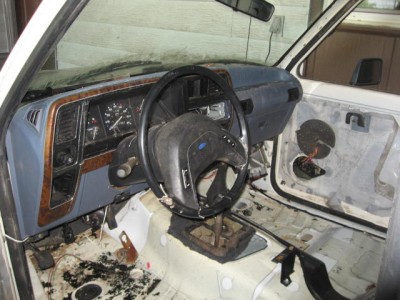

So it's not going to be as hard as I thought to get it running finding the right parts is the hardest part. Most of the distributor parts are special order and it's just being a pain to get them here. I have everything wired up right now except for the fuel pump which will wait until I at least have it started. As you can see the interior is completely stripped out which is because of the rat urine and crap that was inside it. The motor turns over and as soon as the distributor is back in and wired up I think it will start. I need to figure out my power steering pump mount which wont be to hard I think the 2.9l mount will work with some modification.

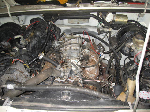

This is the 2.8L out of the '78 Mustang

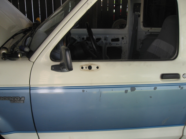

I moved the mirrors up closer to the front of the door just another one of the silly things Ford did by putting them in the middle.
I have rewired the power windows and locks so that all works again now. Once I figure out the brake light situation I'm having I'll be driving it everyday.
