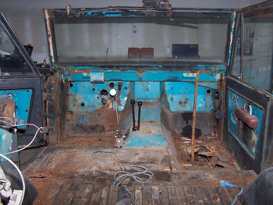

as y'all can see I have alot of work to do.

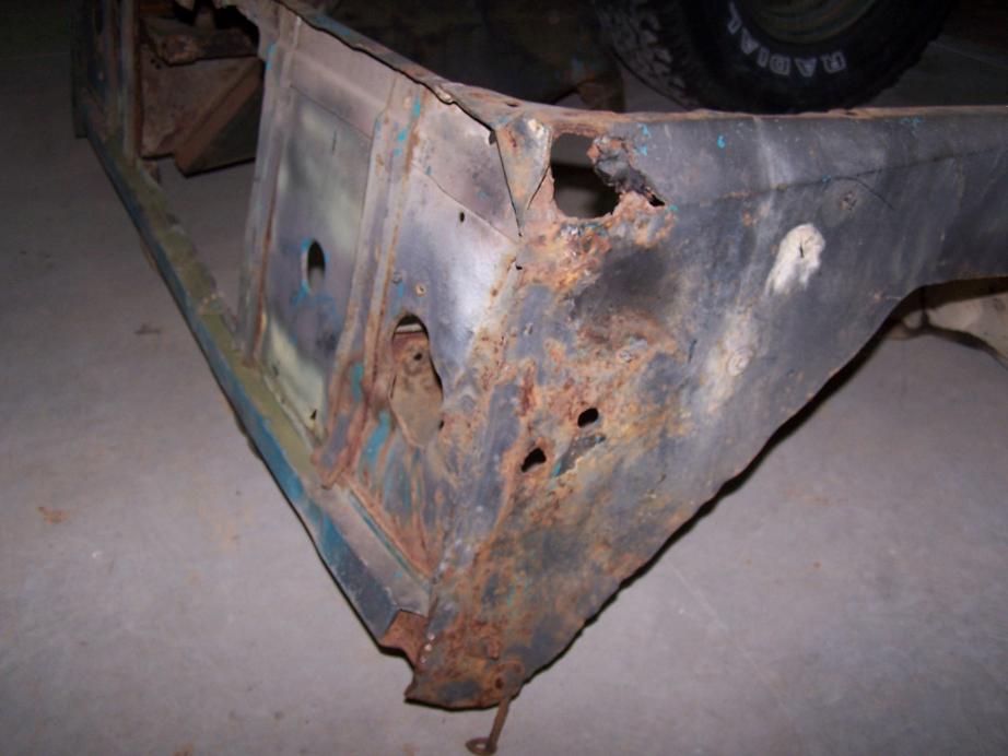

the front floor pans are shot and a couple of the floor supports are completly gone. the tub is actualy leaning on the driver door so I have my work cut out for me. I just went ahead and cut the front off to build a tub front end and make it removable so I can actualy work on it better, and who wants to pay for all that repop stuff when you can build it better for half the price!
this is going to be a slow process but I figured if I was sharing it might help me move a long alittle faster.
what I have done so far: floor shifter, disk brakes, twin stick, full width rear, and beat out the floor pans with a screw driver....

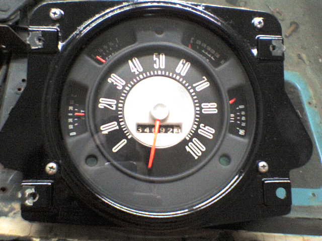

well, I am a little late posting this but last weekend I cleaned up the speedo. it came out pretty good. I took this with my phone because my good camera is MIA.
I also finished pulling the rest of the wireing out and took everything off the dash. I plan to start on the simple stuff right now untill I get the welder situation figured out...

When I bought my Bronco, I set the speedo back to zero using this instructions. It was really easy.
http://classicbroncos.com/speedoreset.shtml
I saw that and used it to take mine apart to repaint.
the reason I didn't want to do that is here if the speedo has a way different reading then the paper work when you tag it they mark your title with an * and it is worth less. that and I can write down the milage and keep track...
I didn't expect the pic to look that good either...I guess phones finaly are starting to catch up!

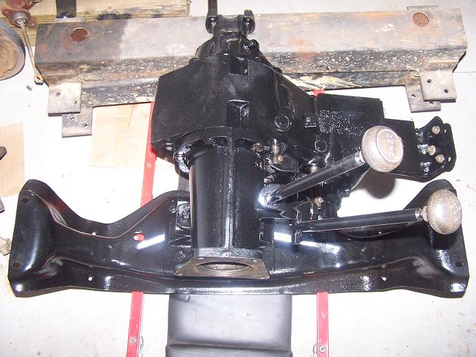

well, I haven't exactly been working on bronco stuff but it is moving me in a direction. so here are some pic's of what I have been working on!

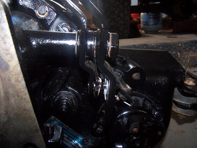

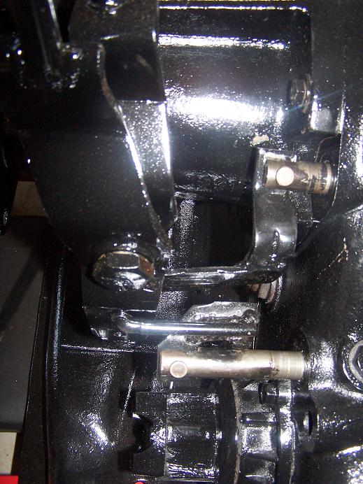

twin sticked the 205, fabbed my shifters and everything cost me $0
as you can see I used the factory shifter for the 205 and a d21 shifter. I cut down the part that the bolt goes threw. then altered where the bar mounted to the flat part of the d21 shifter. it shifts nice. as y'all can also see I cleaned everything up, painted, and started reassembling.

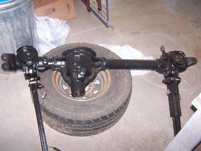

here is a pic of the 79 D44 I am reworking

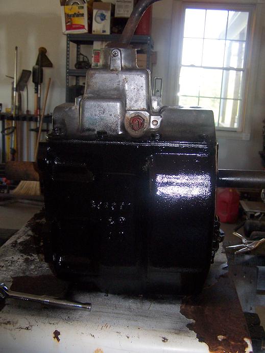

and the np435 I just got done repainting. I am going to pull it apart and check everything and throw some new gaskets on it since I found the broken bearing retainer...

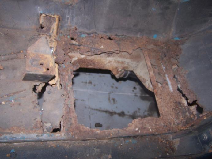

I pulled the motor tranny and transfer out of the bronco to start cleaning and painting also am in the process of making the decission of do I throw the tub away and find a better one or repair...
