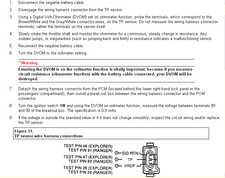

How can I test my throttle postion sensor to see if its bad. Also how can I test the o2 sensor. Truck still runs kinda funky and was just going through the possiblilties.
From my Chilton CD.
Also check out http://www.fordfuelinjection.com/index.php?p=30[/quote]
