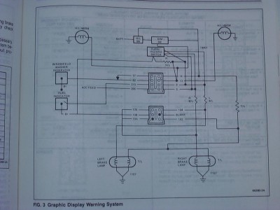

Well, according to the '84 shop manual the procedure is thus:
Connect a digital voltmeter between Terminal No. 215 (Yellow/Black Dots) (Low Fuel Sense), and Terminal No. 57 (Black)
With the ignition switch either in "ACC" or "RUN" position and the fuel tank being below a pre-determined level, the voltage accross Terminal No. 215 and 57 shall be approx 12V +/- 1.5v.
The Warning Switch is in the Console.

Wiring diagram
Rufinit; Which manual are you using for wiring info. I'd like to buy a "good" manual to have on hand. Thanks
I have the '83 Ranger/'84 Bronco II FORD Shop Manual. The one they actually use in the Ford garages. It is extremely good. If you can find one on eBay, I've seen them go for around $50. Well worth the time and effort spent with the other manuals. I also have the Haynes and Chilton manuals, but the Ford is much, much better. I happened across mine at a used car dealership and they gave it to me. Happy hunting.
