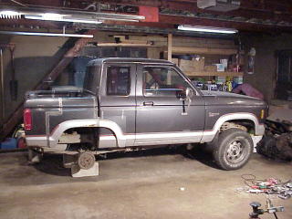

Does any body know off hand if an 88' ranger extened cab will fit in place of the bronco II body. My bronco II body is well beyond repair and it alot easier for me to find a ranger cab. Plus I think it would look cool with a short flat bed. I think the front cab mounts would work fine but I'm curious about if the mid bronco II mount will line up with the rear ranger cab mount. Any idea's? Has any body else ever tried this? Thanx in advance.
http://www.therangerstation.com/galleri ... neR2_3.JPG
there's a guy goes by the name paulsaddress. he did it. a lot of work. the rear cab mount needs to be modded, and the bottom rear corners of the cab have to be relieved as well. i can't rememebr what site he frequents...you'll find him.
Here is Paul's truck.BDEUCE wrote:http://www.therangerstation.com/galleri ... neR2_3.JPG
It's getting a Major overhaul right now with some tube work.
