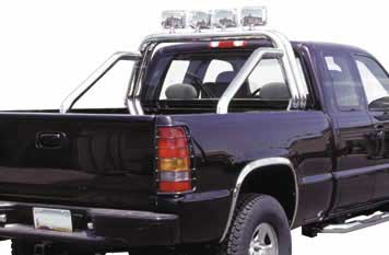

i want to put a cage inside. more of a desert / baja style - think of a "light bar" for pickup trucks:
