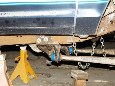

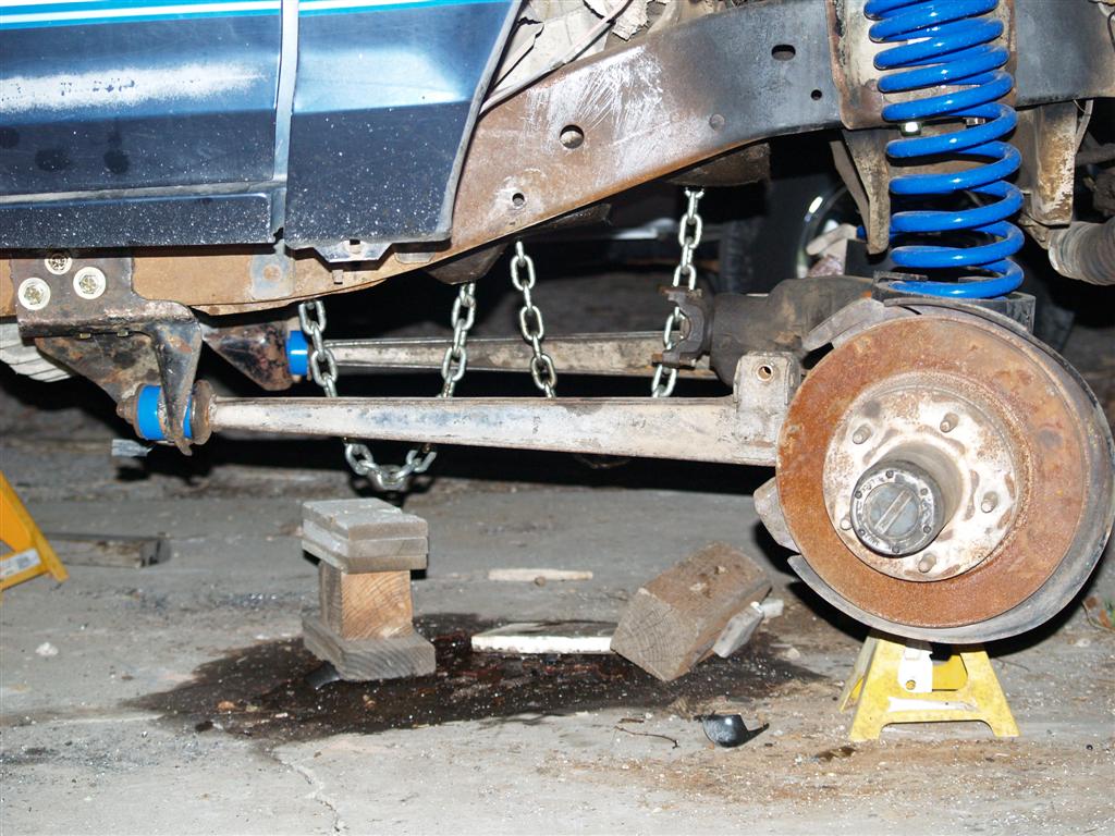

Hey just an update since we are moving tomorrow into our new house finally. Here are couple of pics of the d44 installed. I know, its about time....
I need to move the coil bucket back the the front holes to help with spring arch.
whole front
whole front
radius arms
radius arms

The coil bow comes with the territory. Part of the problem is the coils cups are at a different angle than the buckets. You can shim the cups a to help a little. But overall, that's a fine tuning thing. You don't have to worry about your coils popping out.

you mean the bottom coil top or bottom buckets? tops are EB bottom are Bob Meyers custom. I can still move them a little to help out.
i ment top buckets... did you mount them at the angle of the old buckets?i mounted mine as close as possible to straight to get rid of the bow.
Posts: 1193
I got those top buckets from an EB frame. I had to cut them off as they were welded on. I installed them flush, just like they were on the original frame. I am not too worried the flex as much as I am wondering what i am going to do for steering.
The lower buckets can also be moved back a little so that might help them line up better as well.
